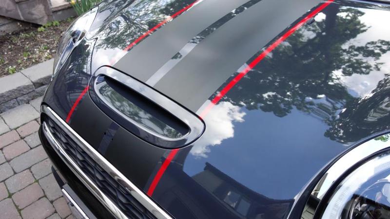

Angry - First off why go with a Bra. Get the whole hood done. I was quoted under $500 for Xpel. If you went this way then get it done after as it will change the color.
Any vinyl does not last that long 2 -5 years. Matte will not last as long as gloss - it is more porous to be matte. I doubt there is a true matte anyway - they all have a slight glass. I think 3M have the least glossy matte - I have both Avery and the 3M on my car.
You have to be careful not to put wax on the matte as it will mark it and also not rub it too hard as it will create a glossy spot.
