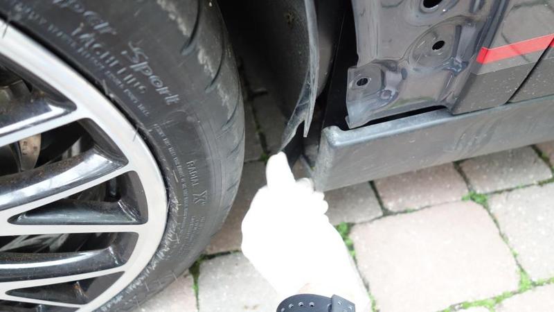

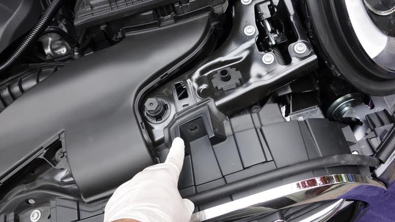

Step 1
Remove the front wheel arch trim.
These use clips that will break if you are not careful.
Open the hood and use a slot screwdriver between them and the body of the car to pop them off. Work from the top of the arch down.

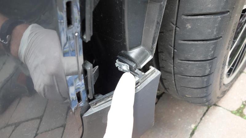

Once all the clips are off you need to get the front 2 slot clips out of the lower bumper trim. They will pull out with the help of a slot driver.
The lower back has to slide forward so you need to pull the liner free at the bottom to slide it past. Make sure you unplug the lights.

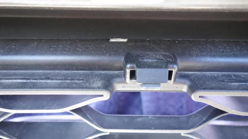

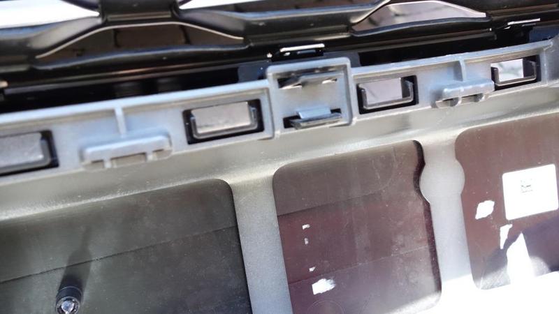

Pictures from the dark side....I personally would pull the bumper to do this. But for those with thin arms...On most of these one part lifts to release the other part. It's designed for quick assembly - you have to bee careful when dismantling it if you are doing it blind especially the ones on the bottom of the top grill.
