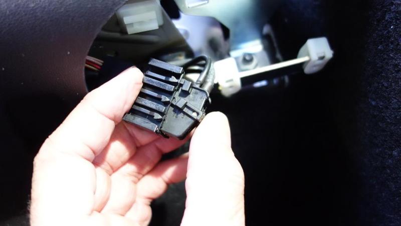

Step 2 - Disconnect the power and antennas
After the cup holder has been removed these are clearly visible on either side of the back of the console.
There seem to be 2 antennas and 1 power/network cable. These pull apart by pushing in the same plastic release clips.
Attached Thumbnails Armrest Removal (Pics) Part 1-dsc02330.jpg   Armrest Removal (Pics) Part 1-dsc02331.jpg   Armrest Removal (Pics) Part 1-dsc02333.jpg
