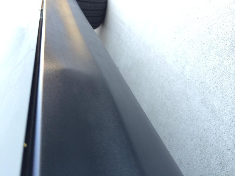

Old Jun 5, 2014 | 07:52 PM
  #48
helipadforme's Avatar
helipadforme
Joined: Mar 2014
Posts: 32
Not sure what this is yet, but the exterior plastic rocker on the driver's side is being damaged by something inside. This is about center in the door opening and when you feel the plastic piece, there is clearly something under it. The first picture shows the outline of whatever is inside. The second picture shows the extent of the warping pretty well if you look at the lines of the plastic.

Old Jun 5, 2014 | 10:11 PM
  #49
shraz's Avatar
shraz
Joined: Mar 2014
Posts: 152
From: California
Umm i see a dent in your bottom frame on the 2nd pic. Seems that it might have pushed up your black plastic piece up.
My sun visor (mirror flap) also got damaged. They've ordered the wrong side so I have to wait longer.
Old Jun 6, 2014 | 08:10 AM
  #50
helipadforme
Joined: Mar 2014
Posts: 32
That dent is the issue. There is some bar inside the rocker panel that is pushing outwards and causing the dent. The first picture more clearly shows an outline of the object and when you feel the panel, there is definitely something hard underneath, unlike the rest of it. It'll be interesting to see what it is.
