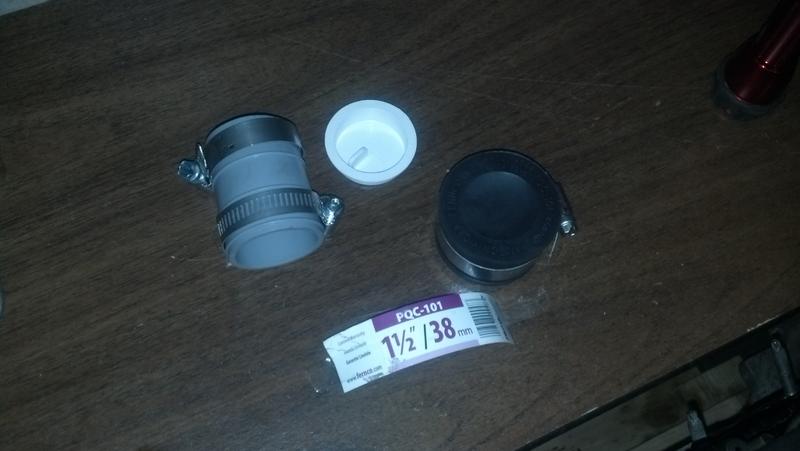

Originally Posted by BubbaJCW
@GregoryK
Can you show us a pic of your F56 and where this noise maker is located at to be blocked.
What color you have?
Below are the pics of my home-made noise-maker delete kit with $5 worth of HomeDepot plumbing supplies (DOS are out of business).
I took noise-maker plumbing out mostly because I was working on the intake regardless. I can't say that I noticed any performance gains or much in the way of noise reduction. OTOH, I do have an open K&N intake kit, and it makes more noise than noise-maker could ever aspire.
HTH,
a
Attached Thumbnails Engine noise enhancer-img_20140628_212319_528.jpg   Engine noise enhancer-img_20140628_212849_760.jpg   Engine noise enhancer-img_20140701_092823_645.jpg
