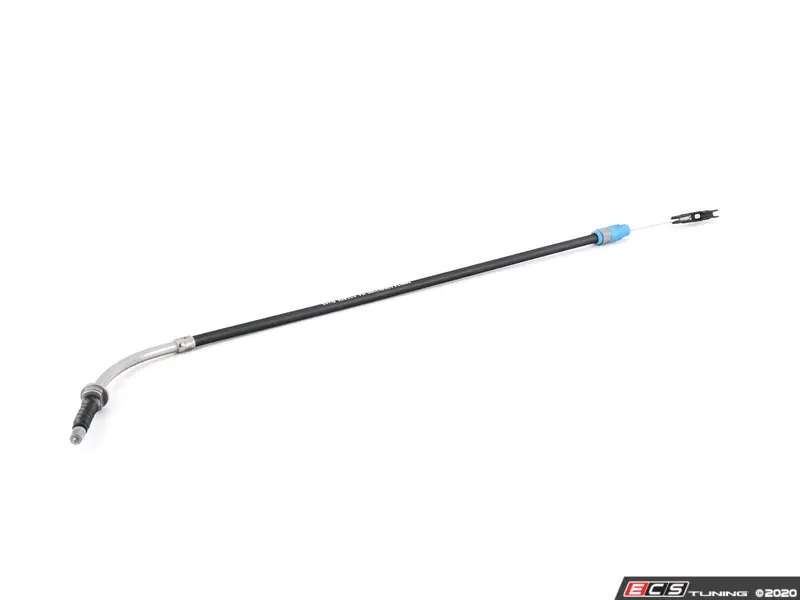

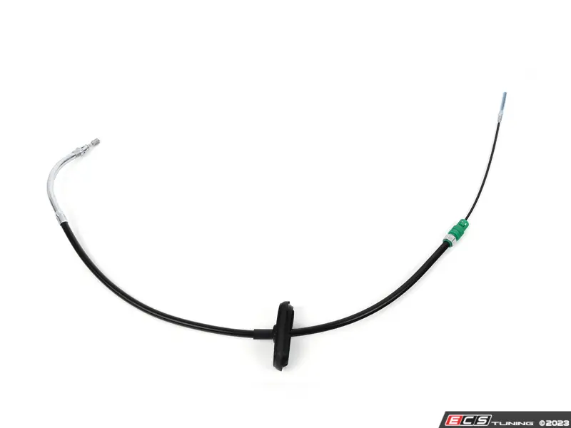

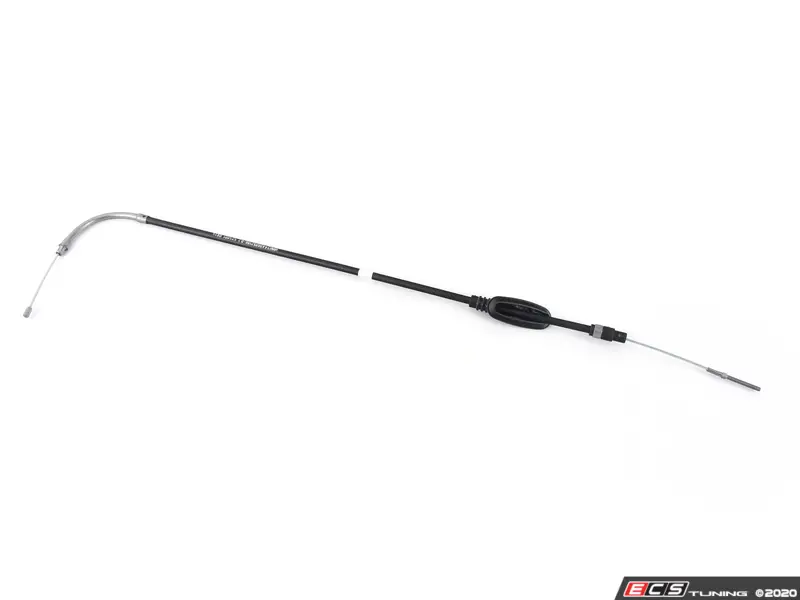

Yep sticking rear brake cables. Its common on the Gen 1 and Gen 2 MINIs. https://www.northamericanmotoring.co...in-an-r53.html
https://www.northamericanmotoring.co...-cables-430861
They are similar but a bit different set up on the F56+. I would get them at least free and lubed on the old ones.
Great DIY for brakes. Check out the rear brakes and how they slide and work.
F56 Diagram for the parking brakes, E brakes. Below the cables are linked, its a 3 part system on the F56+
https://www.realoem.com/bmw/enUS/sho...diagId=34_2186
Most people just replace the cables and then with new ones you want to hit them with lube spray inside once a year.
https://www.ecstuning.com/Search/Sit...h/34406852186/
https://www.ecstuning.com/Search/Sit...h/34406852190/
https://www.ecstuning.com/Search/Sit...h/34406852189/
