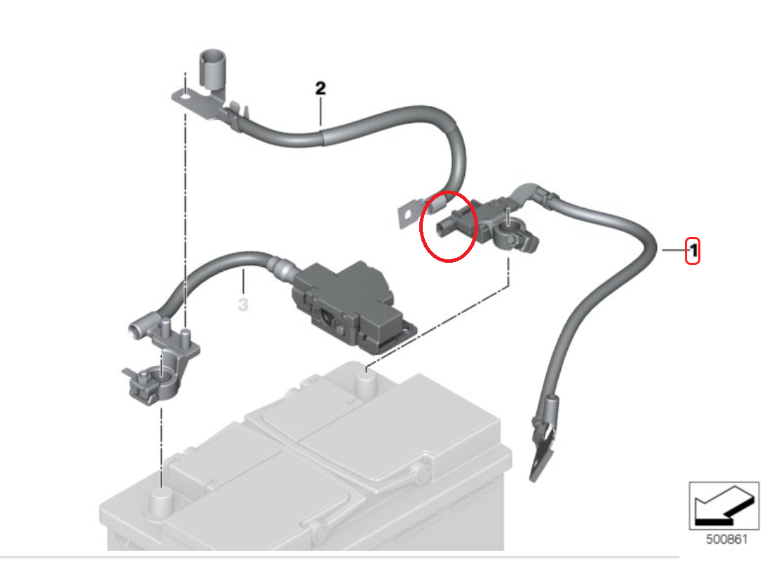

Hey guys,
My f56 17' battery caught on fire this past weekend, not sure what may of have caused it, anyway, I am in the process of replacing most of the cables and can't find a part # for the cable that attaches to the IBS plug on the negative terminal. Does anyone have any idea how I can find it or if anyone knows the part number?
I was not able to find it on any of the diagrams on realoem.
Any help is greatly appreciated!

This is close to it, i cannot find that one exact pictures above. Supply line.
https://www.realoem.com/bmw/enUS/sho...diagId=12_1868
https://www.ecstuning.com/b-genuine-...e/12638628634/
That definitely looks like it to me, FWIW.
I did order that part and should be arriving this weekend, I'll share my findings.

Glad to help, sometimes you have a dig a bit. Some parts are not in realoem and i have to dig around and know the like terms.
