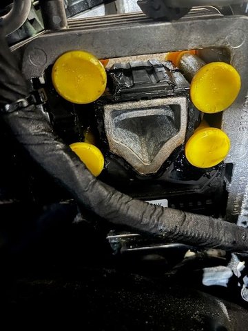

I just installed a set of Powerflex inserts, and for some reason there is a lot of space at the top such that the upper Powerflex is pretty loose. The mounts weren't leaking, the grease is from the silicone grease I used to help the powerflex into their spots.
Any ideas?
When I originally installed it.
After taking the car for a drive.  You can see that the top right mount was pushed into the top right corner.

Looks like the bellow on the bottom must of leaked out and collapse a bit. New one below, i bet yours is past its life and you need a new one, then reuse those inserts to help prolong its life.
https://www.northamericanmotoring.co...placement.html
New
Torn/leaked and collapsed
Please select the correct ones for your year and model and replace.

The car is a 17 JCW and has 50K miles on it. I'm not the original owner so don't know if it's been changed.
Makes sense though.
I'll take a closer pic of the bottom of it and see what it looks like.

Yep, Glad to help.
https://www.ecstuning.com/Mini-2017-.../Engine/Mount/
Thats the mount you need linked above.
We see in high TQ/HP MINIs these tend to fail sooner. Good thing is you will have the poly to help the next one. We also have lifetime replacement.

I was just checking the existing mount on the car, and noticed the trim bolt is missing. This means that the mount was likely already changed.
I’m thinking is it possible that the problem is the lower mount instead? How would I determine that?

Check the lower mount on the engine connection. Most of the time its just that upper side mount. Some people even do the transmission mount at the same time to make sure everything is good.
