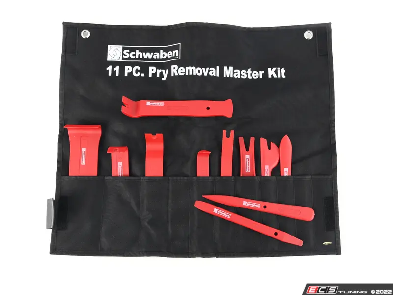

Get a trim tool kit so you dont beat up the inside panel.
https://www.ecstuning.com/b-schwaben...ieces/phr-11s/
