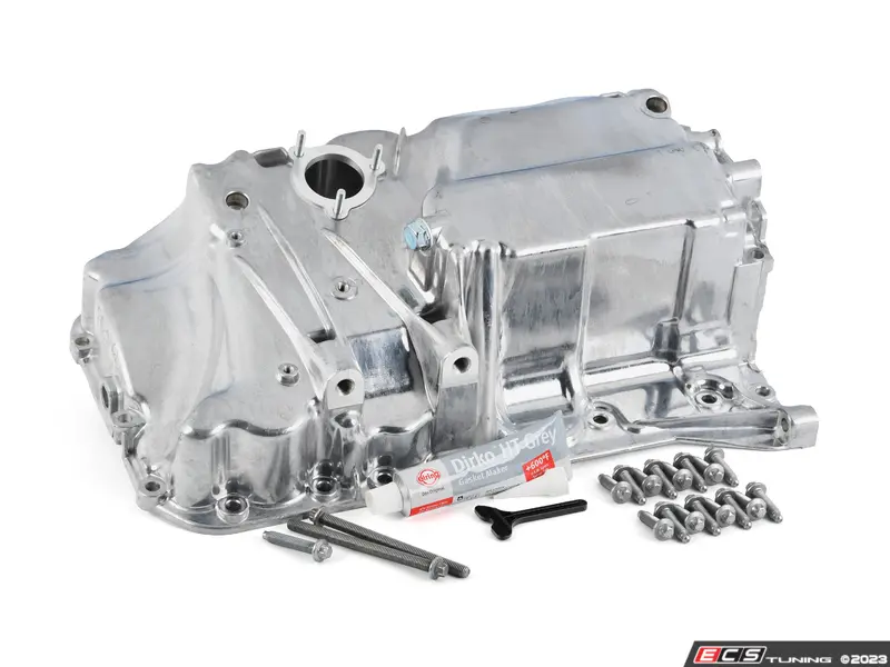

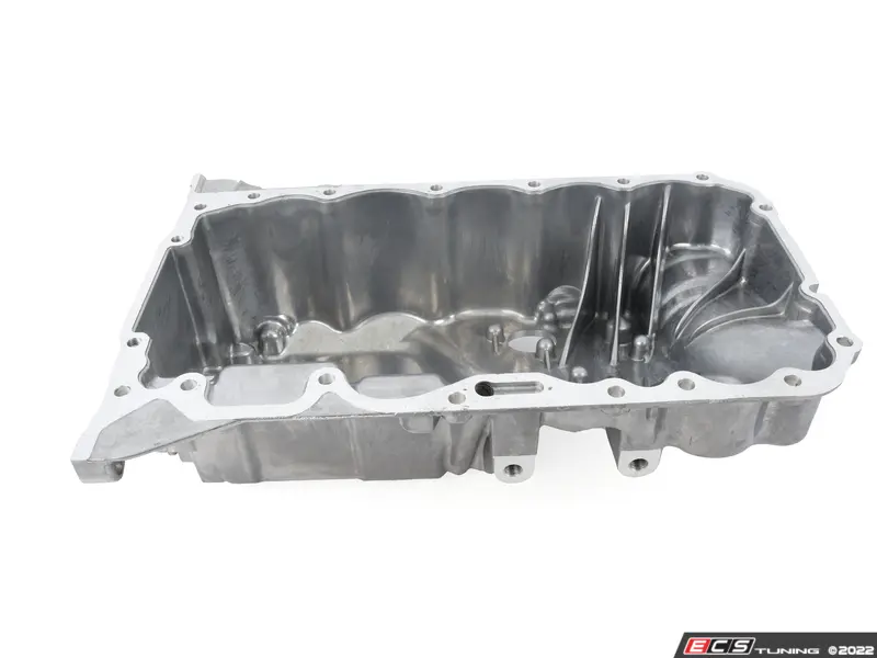

We have aftermarket ones here in stock, i bet he is just buying ours (drilled it) and putting a dip stick in it from what looks like an R50/R52 dipstick. looks like the one on my r52?
We have the pans here and they have the casting like the genuine one and its blocked off: https://www.ecstuning.com/Search/Sit...h/11138590017/
Yes have not seen ones change, most people are doing the filter housing, but yes you would have to take those bolts out and tilt the transmission out a little.

Yep, we have more and more aftermarket landing ever day under Bremmen Parts. https://www.ecstuning.com/b-bremmen-parts/v-mini/
We have install kits also that come with the sealant, elring is oem on most gaskets and sealant without the MINI high prices Under assembled by ECS.
https://www.ecstuning.com/b-assemble...11138590017kt/

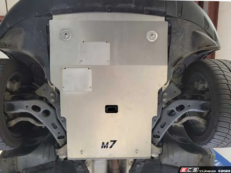

To protect the pan for the F60/F54
https://www.ecstuning.com/b-m7-speed...70-130100~m7s/

ECS Tuning : I checked your link For the protection plank and in the “fits these cars” it says it doesn’t fit F54 JCW all4.
Old Dec 1, 2023 | 01:18 PM
Posts: 36,758
Likes: 2,548
Glitched, i fixed it.
