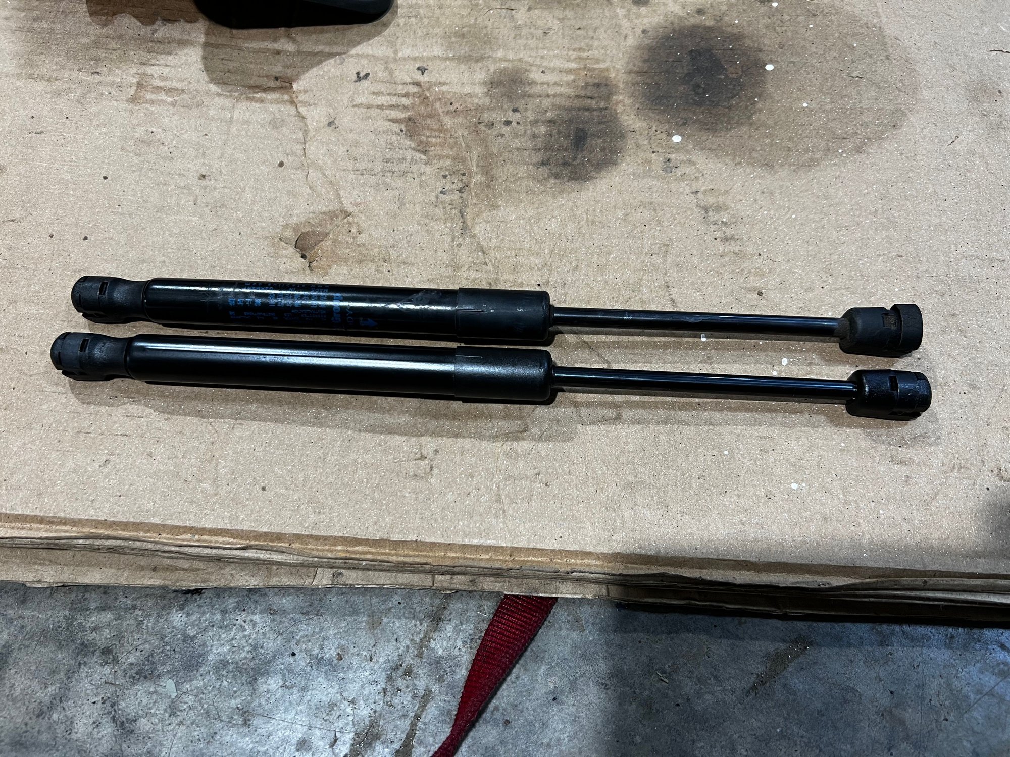

First tip. Don’t buy the Genuine MINI ones for $50+ each. RockAuto sells Stabilus 5B691459 for $8.79 each. Literally the exact same part. Made in Germany and everything.

Top: BMW/MINI 51247348917
Bottom: Stabilius 5B691459

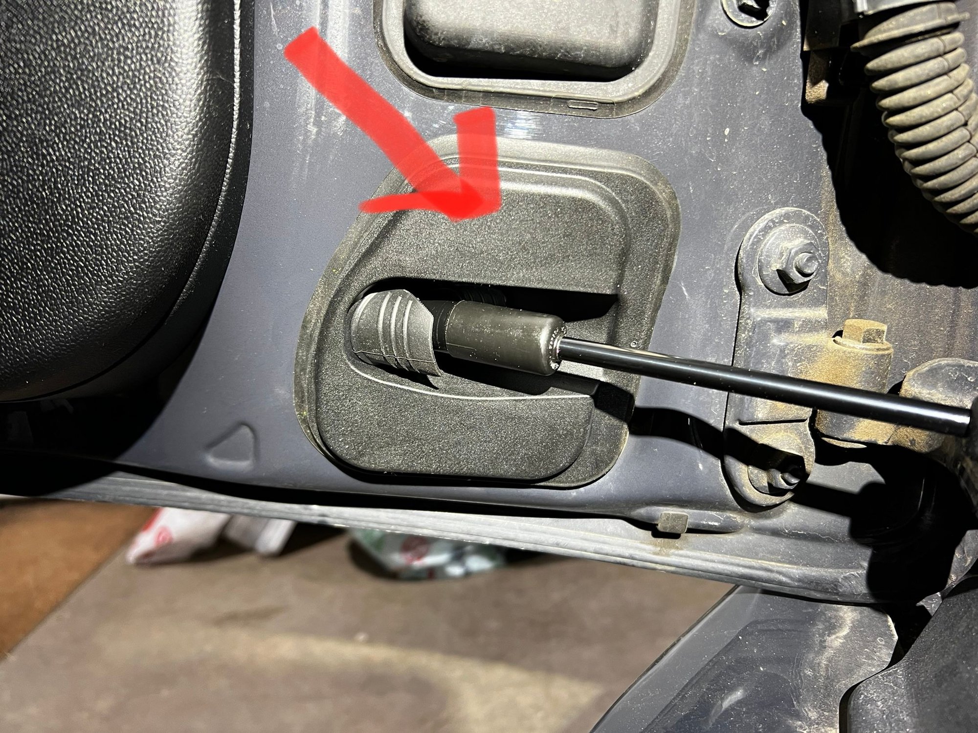

Other tips. Pop off the tail light bulb access door and you can access at least 2 trim rivets. Popping a couple trim rivets with a trim tool first will help immensely when popping off the main door trim panel.
Don’t pop off this trim/rubber boot piece. I broke the clips holding this on and had to order new ones. Instead, after the the main trim panel is off and you unclip the gas spring, you can slide the gas spring inside the door and remove it. Spray a little silcone lubricant to help it slide through the rubber boot.
Here’s the view of the gas spring once you get the door panel off.
