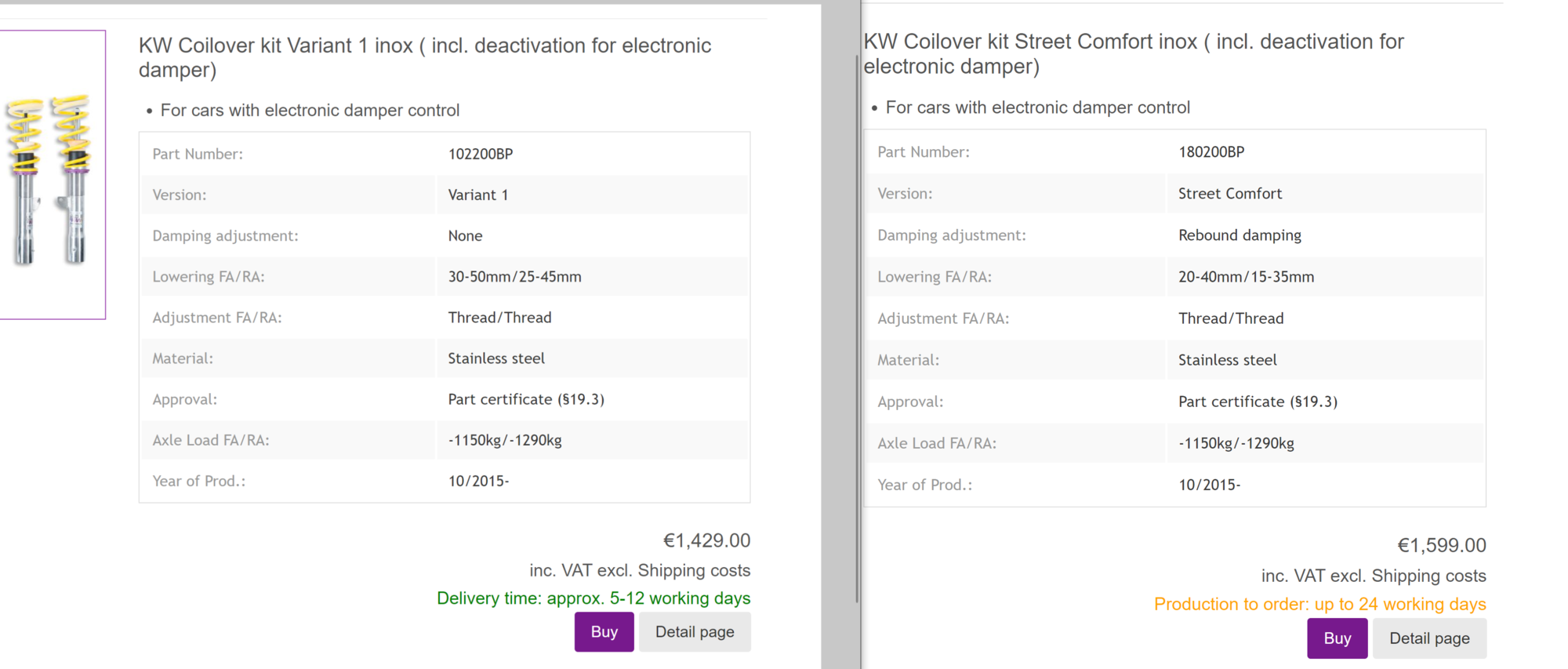

So I was just lookin through the stats for the Street Comforts and the V1, and I saw a few interesting things. First, I initially thought that the SC < V1 < V2, V3, etc. But I guess the V1 is the "base" model, which does not have any dampening adjustability, while the Street Comforts do have it. But the V1 has greater ride height adjustment.
KW V1 vs KW SC
