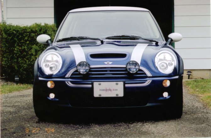

Emailed PIAA b/4 I did this
PIAA Stated that the wiring harness would work just fine. I've had my 55w installed for 1 1/2 years with no problems.

I think I will replace them shortly then. Maybe with these: http://www.shopatron.com/product/pro...PIA13900/353.0

The lights I was talking about.
Tiny little things. Have you used them yet? Do they throw enuff light for you?
I have used them, but I don't think I have them aimed properly yet. I have them shooting downwards so they don't dazzle anyone on accident. I was a little disappointed with how much light they put out, so that's why I want to swap out the 35w bulbs for 55w. The Xenon headlamps overwhelm them, so right now they just add a touch more light. First I will have to aim them right and then I will swap out the bulbs to try to get them to throw more light.
Thats why I asked. In the case of auxiliary lighting, Size Counts!
The reflectors just ain't big enuff to do much. Go to 55, its a bit brighter, but the reflector is still small.
Good luck though! It always good to have more LIGHT!
