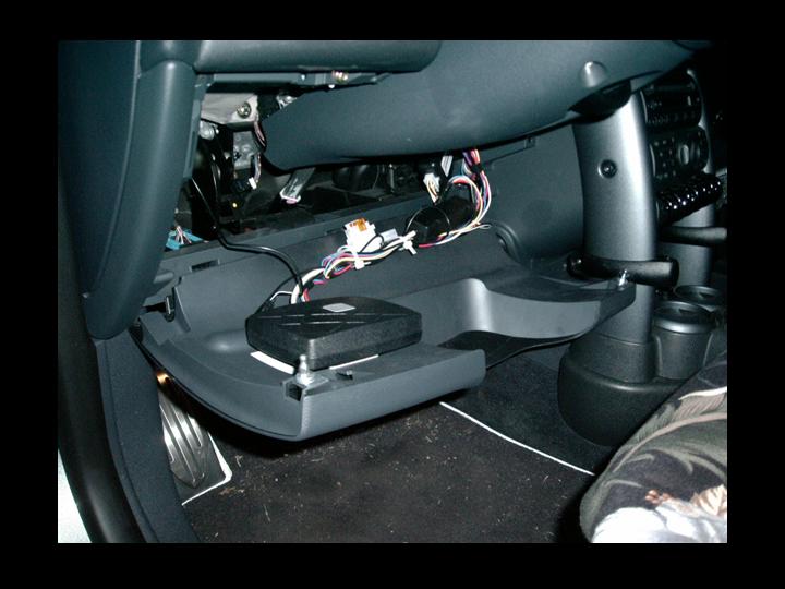

I finally received all of the components needed to setup my bluetooth in my '05 MCS. HK w/ Factory NAV (Parts from www.newministuff.com and E-Bay CK-7W) Total cost around $300.00. What I am looking for is any techincal advice with the install. Where do the components mount? How do I route the microphone wire since there are airbags mounted in the pillars? Are there any pics to be had? Any help will be appreciated.

Installation Complete!!
It took about an hour to install the complete setup I installed the CK-7W unit on the cover below the steering column. I used velcro to hold it in place and zip tied the wires together next to it on the cover. No rattles!
Question, using my RAZR Bluetooth, is the speed dial from the phone supposed to show up on the NAV screen? And isn't the phone supposed to show up on the main menu of the NAV screen? It appears to have a screen of its own. Is there a manual out there showing how the Mini phone is supposed to work?

Pics
I hope these pictures help. I used velcro supplied with the CK-7W to hold the microphone in place.
