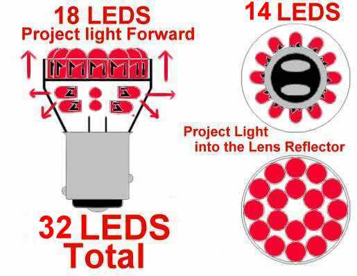

it looks to me like alot of those have extra LEDs for the angles so that there is more light and such. Please correct me if i am wrong. I know it wont look at cool as a car with factory LEDs but i think it would still be cool.

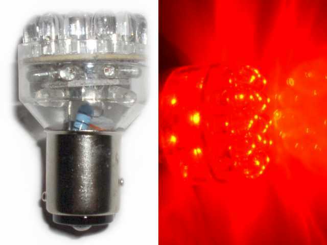

Okay, final comments on this thread.
For those above who had problems with illumination using LED's in the tails I would say this was due to 2 issues. First you are using a red LED in a red lenses. This is gonna make the brightness significantly less. Also I think you need to use one of the 32 bulb tower assemblies shown above from autoluminations.com.
Finally you can use the 02-04 setup as I wrote earlier. Here's what to do:
1-Buy the sets from outmotoring.com
2-Buy 2 clear/white LED 32 bulb 1156 towers from autoluminations.com
3-Buy 2 amber LED 32 bulb 1156 towers as well
4-You will need dual function LED for the brake/running lights. I don't know for sure if autoluminations sells these or not.
5-Remove the soldered in standard bulbs from the assemblies you have purchased from outmotoring.com
6-replace these with the clear in the top position, ambe rin middle position and red in lower position.
7-Plug in the wiring harness and secure to car.
8-Test lighting
9-Enjoy or not.
My experience is the clears are gonna be way brighter than standard clear reverse lights but the ambers and reds may or may not be. Your DOT issues may vary. Do it if you want, don't if you are worried about being legal.
