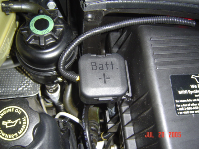

I pulled mine off the jump point under the hood. See the pic. I loosened the not and put my wire under it, with a 20A fuse also. Then grounded where the hood grounds.
The more light the merrier!
