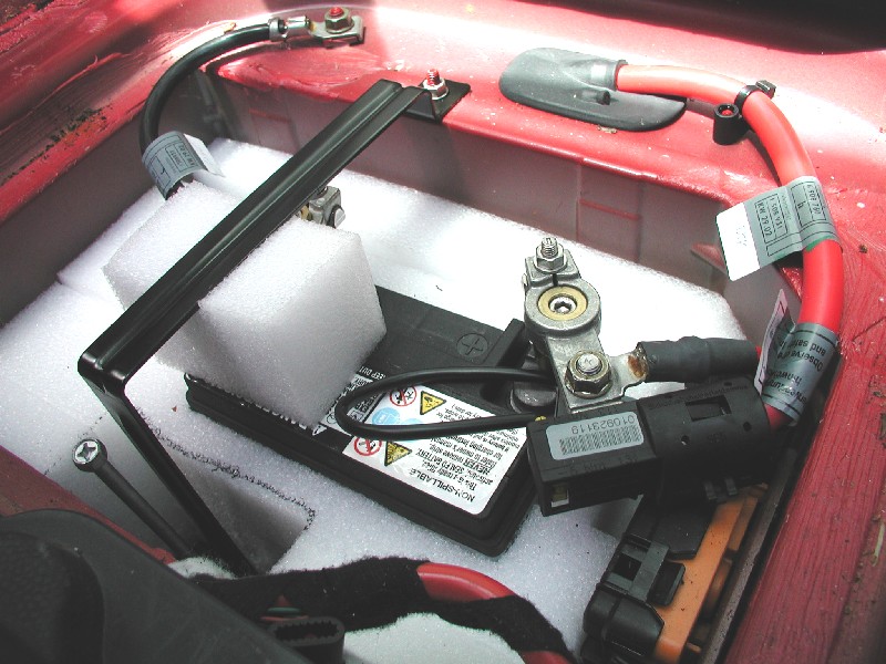

I got this battery for my car. Lost tons of weight, and works great. I've submitted a review and description in the Reviews area, but it has to be approved before you can read all the details. Here are two photo to tease you all!

The foam packing was done by Matt, and not provided. This is not a MINI-specific battery, or install application. It is up to the purchaser to be somewhat creative to make this work. With mine, I removed the battery box, and riveted some aluminum angles to hold her in place, along with a wide velcro strap. I've had mine for about 2 years, and all is well. I think I paid about 70 bucks to my door...
I assume the model number for the Odyssey is PC680? Do I need to buy battery posts or doees it come with them- besides mounting the battery (designing a way to keep it strapped down) it is pretty much plug and play? Thanks guys.
The Braille one that Matt has does come with posts, I believe. The Odyssey, at least mine, did not. I got my posts at a local Kragen Auto store for like 5 bucks. Or, one could order a couple on the website when making the battery purchase. Oh, for most, it is the PC680; a search on Odyssey and Battery, and several threads should be found...
If one keeps the battery box, it's really quite easy to secure it. I used packing foam after I experimented with expanding foam in the battery box. That was a mistake! You can see some of that crap on my battery as it accidentally came in contact with it...

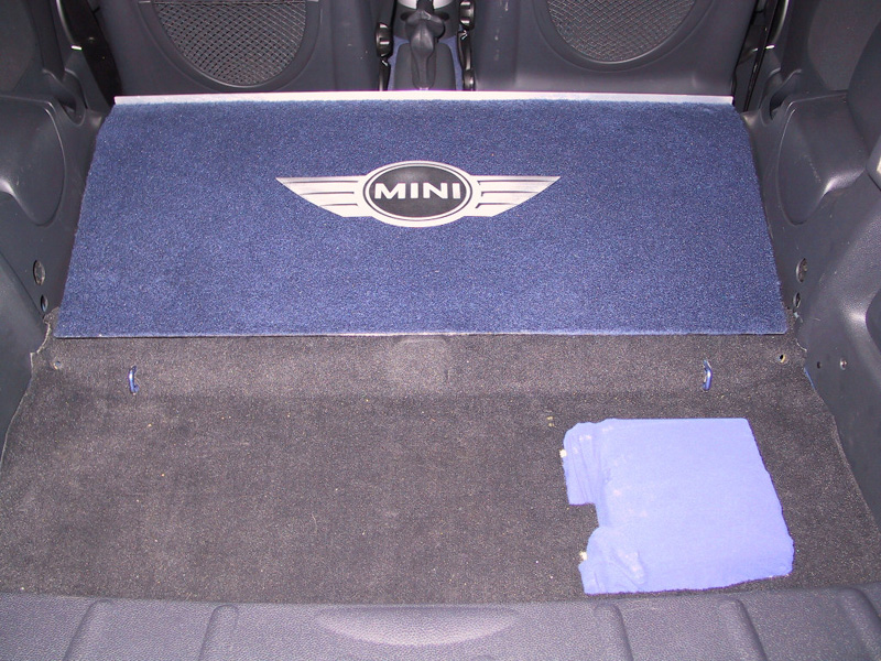

The primary reason I did the battery swap and re-location was for a custom exhaust! I'll include a couple photos here:

Tony B- now it makes sense! I was trying to figure out why you put your battery in the storage compartment versus where the old battery went- very nice exhaust by the way and thanks for all the tips.
If I understand your question correctly, I put the battery off to the side, as opposed to directly over where it was (middle) for a few reasons:
1. I didn't want it right on top of the heat of the muffler as these batteries don't like heat. Oh, and this one good reason to not to put it in the engine bay area. The other is that our cars are already quite front heavy...
2. I didn't want the battery's weight on top of aluminum plate I used to cover the opening left with the removal of the battery box...
3. Weight-distrubtion wise, it sort made sense to go further to the right, better countering me, the driver diagonally. Plus, the cabling works quite well for this orientation; and I experimented with a few...
