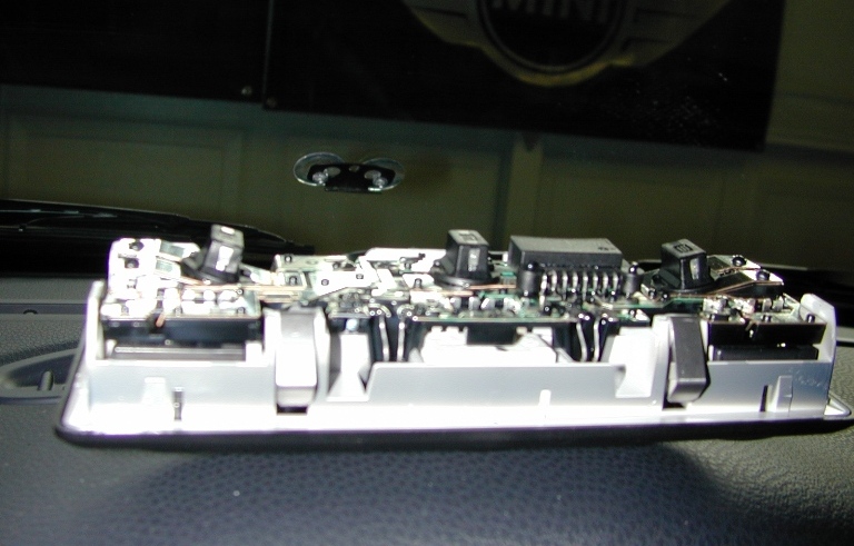

About the light and wire
Originally Posted by antsmini
MINI Rolls:
What is involved in dropping the ambient lights, and what color wire is the one I should splice into?
The attached photos show the light panel removed, on the cabrio it has two spring clips on the side to the rear of the car, gently pry down on the light panel with a screw driver, I wrapped it with a cloth, and the panel will come out. Unplug the cannon plug and set the light aside. The Wire going to the mirror is green and yellow; check it for power with a test light or multi-meter, a sharp point on the tester will go through the plastic of the wire with no problem. I then used a quick splice so that I did not have to cut the wire and it is removable. Drilled a hole in the frame and attached the ground and done. Pretty easy.

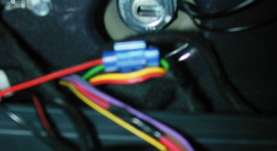

Awesome, thanks Rolls. One more question...what is a quick splice? I hate cutting into wires.
A quick splice is a an adapter that clips on a wire and the second wire sits in inside of it also. There is a metal piece in the middle of the splice and that metal piece pushes down into the splice and nicks through the outside cover of the wire and allows current to flow across one wire to the other. When you want to remove it you pry it open pull out the wire and put a small piece of tape over the spot. I use these in the brakelight mod kits that I sell.
Here is a photo of what they look like, you can get them at most auto parts stores and places like target or Walmart.

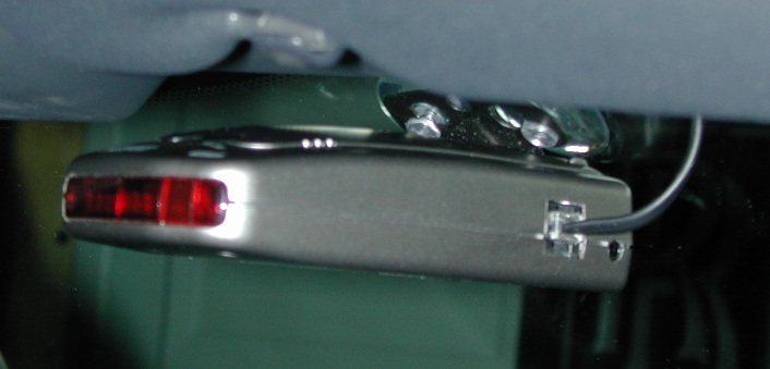

I Hard Wired mine today , and thanks to all of ya`lls input made it a very easy operation.
Heres where mine ended up .

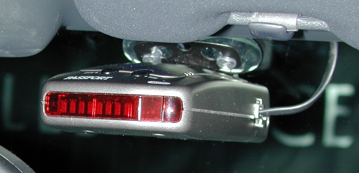

This is just a preference thing. If you can have a short wire run and still have the power you then so be it. Running from the light assembly and just having wire shorter is better for me. The small piece of the headliner in the CABRIO is hard plastic not same as the hardtop, so running under the headliner is much more difficult. Popping the mirror off and putting the power plug out the front was simple, this install took all of 10 minutes. But for those that want to run to the fuse box that is your choice.
Here is the install completed;
Attached Thumbnails Wiring a V1 radar detector on 05s?-passport1.jpg   Wiring a V1 radar detector on 05s?-passport2.jpg
