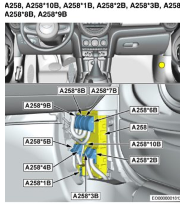

The BDC is in the passenger side footwell under the dash. I recommend removing the glove box to make some more room to work
The connector you’re adding the wires to is A258*3B. Unplug the connector from the BDC and remove the cap (basically just stick a small flat screwdriver between the cover and the plastic bars with the terminals and they slide out).
Once you get the bars removed you’ll see they’re numbered. The connections follow this diagram:
The fog lights use the wider terminal ends with the yellow wires. The left side is yellow/black into pin 7 and the right side is yellow/brown into pin 8. the DRL wires are the narrow pins with the gray wires. The left side is gray/violet into pin 50 and the right side is gray/yellow into pin 38. The black/green and black/blue wires are parking lights and should already be in your car (pins 39 and 51). Crimp the wire ends on, plug them into the bar, and then plug the connector back in to the BDC. The next part is the hardest part – getting the wiring up to the front of the car. I bought a roll of cloth electrical tape and taped the four wires together into a bundle. I drilled a hole into the rubber firewall grommet right above the BDC to run the wires through (make sure not to hit the existing harness!!!).
