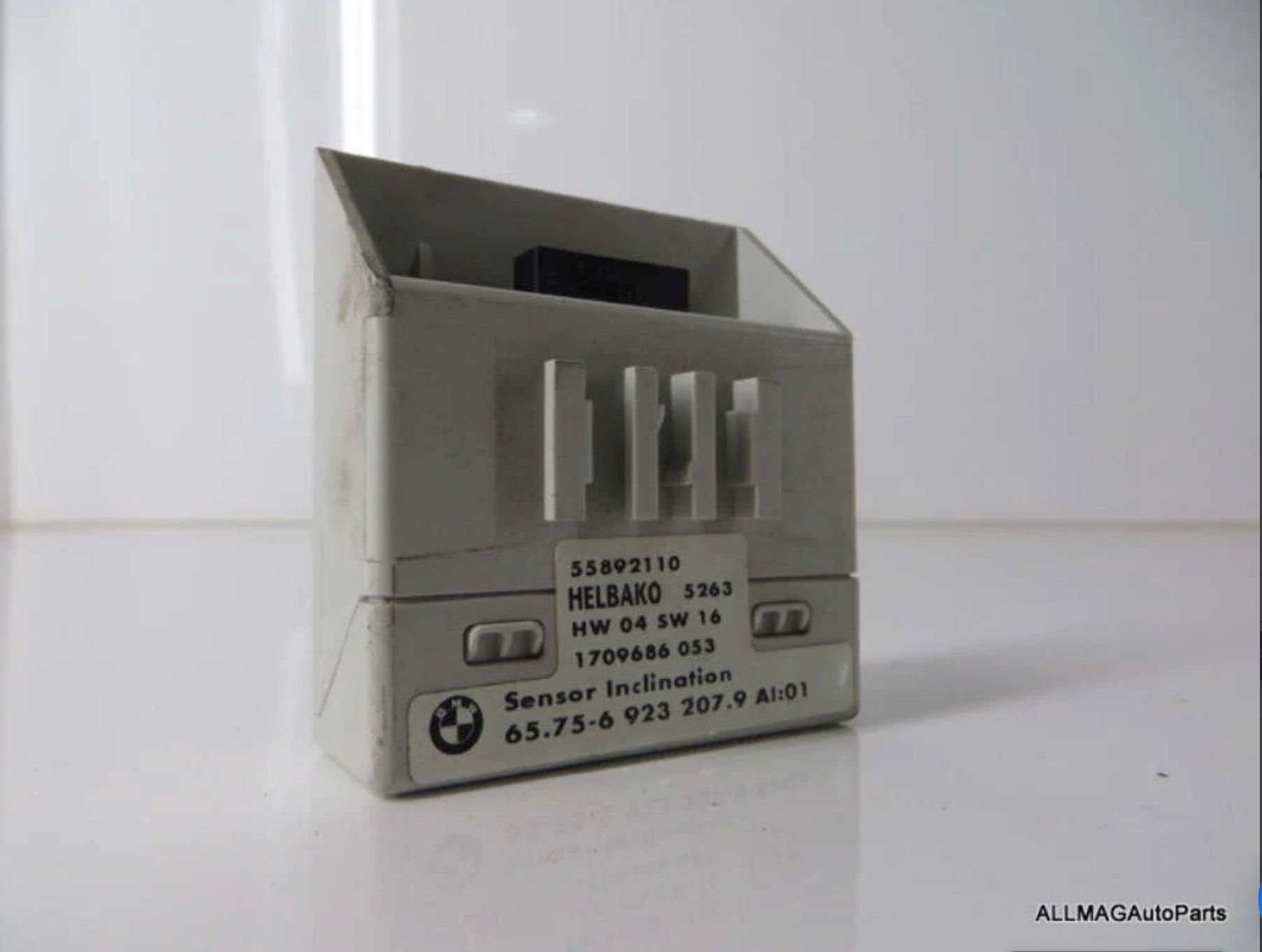

Where was it? Rear side panel somewhere?
I ask because early alarms on mini max e46/z3/e83, etc were two part, with siren under hood amd tilt sensor in the car on a rear side panel.
later alarms were one piece, with tilt and siren combined into one unit under hood.
I ask because I have never seen an early alarm nor that module

Never mind, I found a pic of that part and what you show is not it.
so maybe it is the EWS module.

Looks like the standard EWS module on all cars and prevents starting without the proper key chip. Is it on the firewall behind the pedals?
There was a separate tilt sensor module for the early alarm systems but that was integrated into the siren sometime around the face lift.
edit: the separate tilt sensor is posted above.
