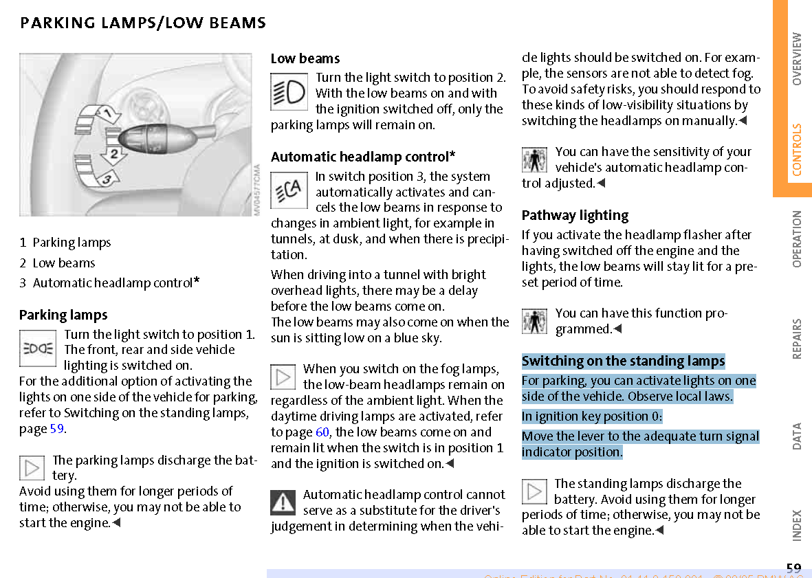

2006 owner's manual (on line)
thanks...I must have missed that looking in my owners manual.....and I agree about it killing the battery
