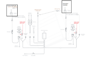

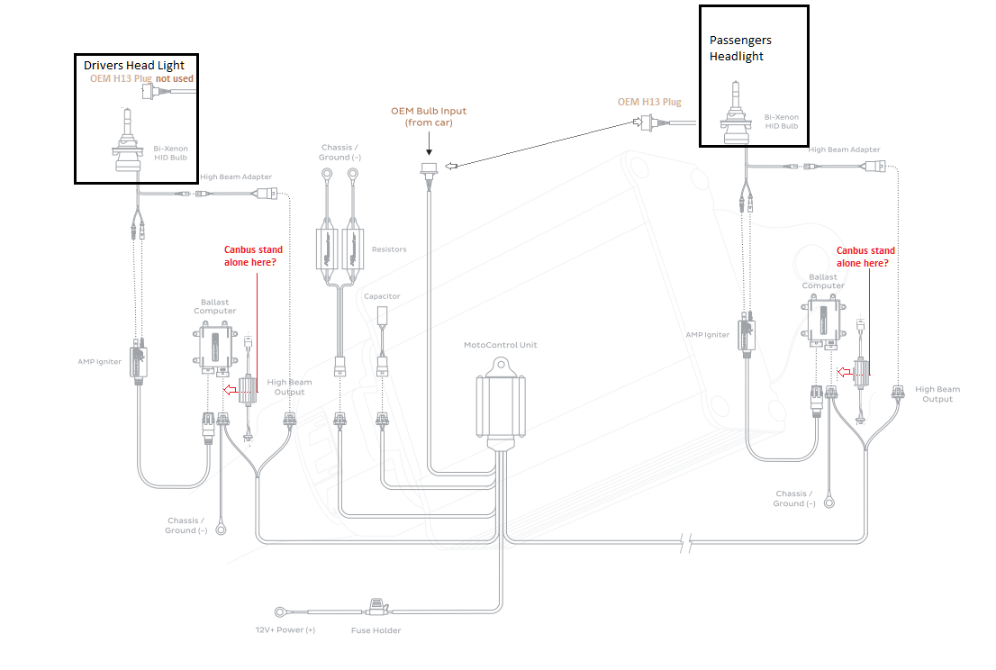

Now onto my wiring and the need to help understanding these Stand Alone Canbus Adapters. Assuming it makes sense and this is deemed what I need. First off, when looking at the Stand Alone Canbus wiring install\instruction pdf, i'm a little confused on exactly what scenario i'm supposed to be following. They have 3 scenarios(Internally wired, Externally and Dual-filament). Now obviously Dual filament is what the car is\was when it was stock. But not with this retrofit, so i'm a little confused there. I want to describe and then also show with the diagram that I made below how I wired these retrofitted lights.
My drivers side light basically has two different connections\wires coming out of it. My AMP connectors from the HID bulb, and a 9006 plug which is the high beam going to the solenoid.
My passenger side light has the same thing, with the additional OEM H13 female connector that originally would of been going to the OEM Halogen H13 bulb on the inside. This is now routed out the back side of this light so it can be used as the trigger source to the H13 harness.(With that being said, the same H13 OEM plug is NOT being used\plugged into anything on the drivers side light since you only need one side to trigger the relay. Wouldn't this cause bulb check\errors no matter what the harness setup is?).
Now onto the H13 harness I'm using as i mentioned previously. The harness is quite simple as i understand it. You basically have two 9006 female output plugs that each go into a ballast. You have two 9006 female output plugs that each connect to the 9006 high beams coming out of the lights. And lastly you have the H13 input trigger connector that in this case connects to the OEM H13 female connector coming out of the passenger side which triggers the entire relay.
From the one TRS representative, it is my understanding that the Stand Alone Canbus modules should be inserted between the harness and the ballast on both sides. If that's the case I would assume I would need the 9005/9006/9012/H10 connection configuration when ordering them. I'm also a little confused though because if you look at some of the specs\details of the product it says its not supposed to be used with a relay harness?
