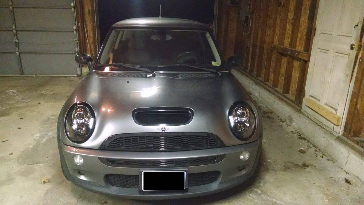

Whats going on everyone? just a quick and simple question for you knowledgable people out there. I just installed some Depo Helix blacked out projector headlights and installed HID bulbs in them. After drilling through the back cover for the bulb area and mounting the ballast to the outside of the housing, I decided to try and fit the entire ballast and all other contents into the housing itself. I managed to squeeze it all in there but here is my question.
Will the ballast produce to much heat if it is in a confined space like the headlight housing? does the ballast produce heat at all? lol. I just don't want to put the headlight in and find out things are melting that shouldn't be. Thanks for any input!
Attached Thumbnails HID Install question-16990070_10208804166046335_32587254_o.jpg   HID Install question-16990688_10208804166166338_928989285_o.jpg   HID Install question-16833047_10208804164406294_459515316_o.jpg   HID Install question-16936369_10208804170406444_1676221517_o.jpg   HID Install question-16991001_10208804170326442_842333643_o.jpg

Yes LOTS of heat

Tons of heat. Also those lights are super easy to unbolt the projector and bolt in a real HID bi-xenon projector. That projector is made for halogen bulbs, the HID bulb will burn up the chrome coating inside the projector bowl over time.
I have the same headlights and had that issue. I have swapped in real HID projectors, since you've already got the ballasts all you need is the projectors and new bulbs.
You can get decent projectors from Theretrofitsource for 25 bucks for a pair and cheap bulbs for like 20 from ebay for the time being.

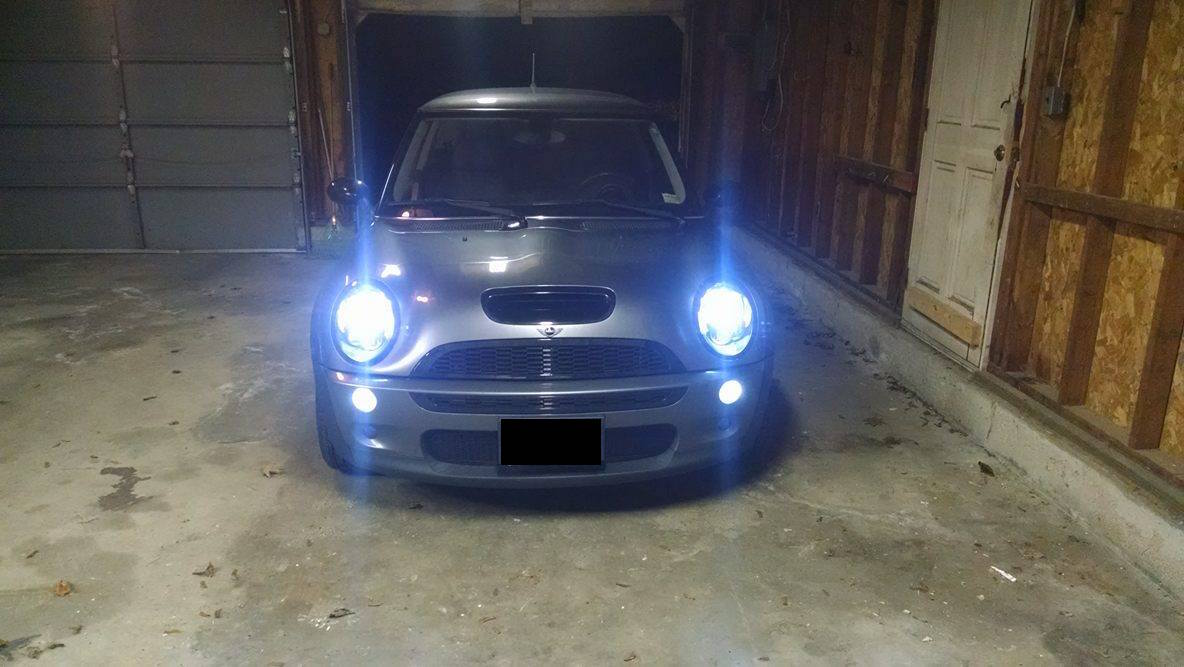

Low beam retrofit projector, just one light being tested after installing new projector.
Old Feb 25, 2017 | 07:35 PM
X757XVeritas's Avatar
X757XVeritas
Joined: Jan 2016
Posts: 649
Likes: 12
Both lights done, this is just low beam

Damn that light output is insane! looks great. and i only see maybe two different projectors around the price you mentioned. They are universal kits. The other ones are all in the hundreds. which did you end up getting?

Originally Posted by X757XVeritas
High beam
Was this with halogen or HID high beams? I thought the housings in question came with projectors for lows, and normal halogen for high?

There are different designs of projectors, not all projectors can use HID bulbs. The Depo lights come with halogen projectors. HID bulbs will burn the chrome out of the bowl on a halogen projector after a year or so making them useless. I have pulled the halogen projectors out of the housings and replaced them with proper HID projectors with a solenoid that flips a shield up and down for low or high beam, as well as tied into the halogen separate high beam bulbs, so I have 4 different bulbs on for my high beams.
That particular picture was just the HID highs though, I had not tied into the halogen highs as well yet.
