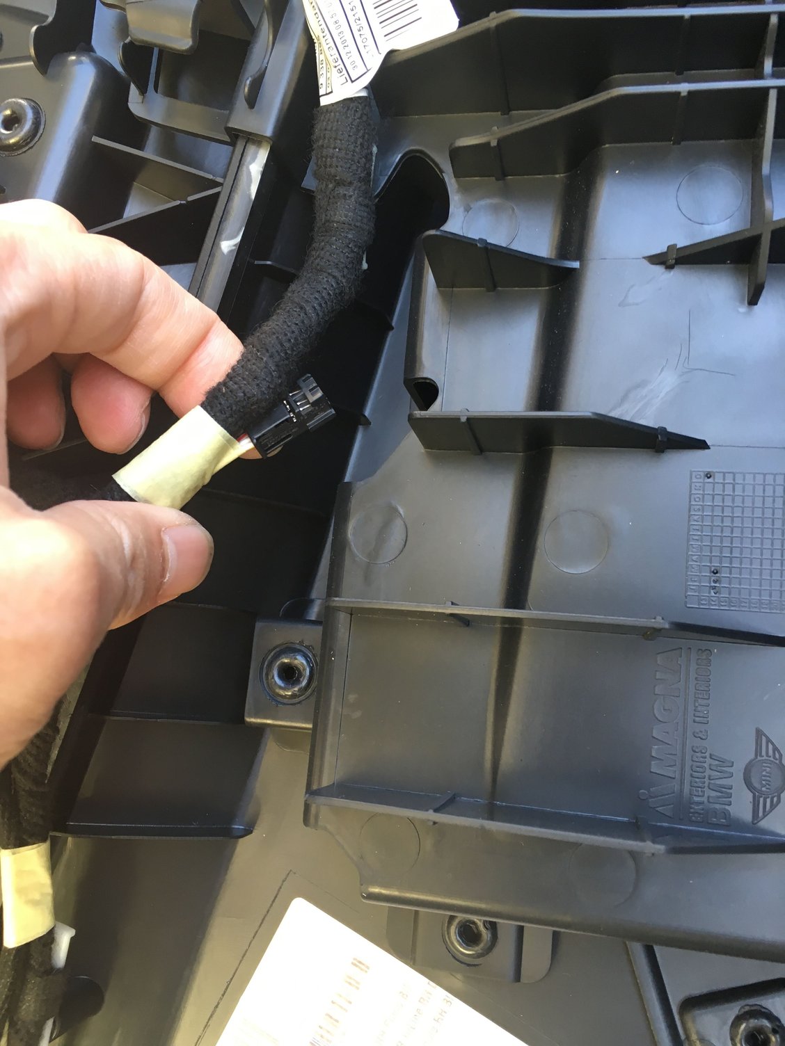

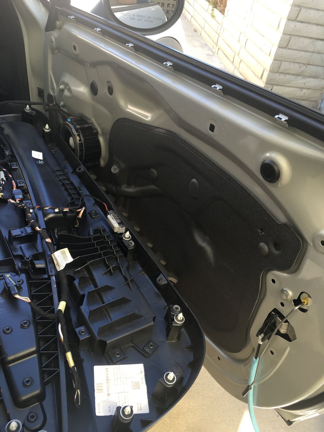

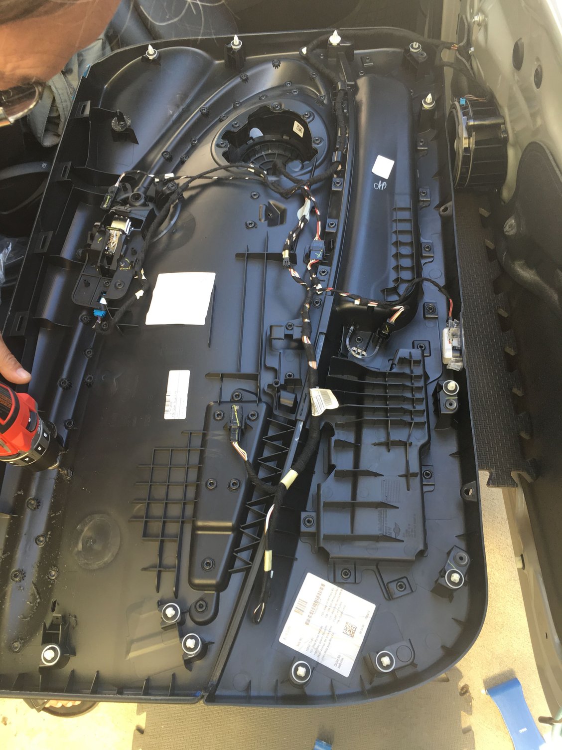

Just did the retrofit of the additional LED lighting that comes with the MINI Yours interior packages, as long as your car has the Lights Package option 563 and the MINI Excitement Pacakge option 4V9 this retrofit is possible as the wiring for the additional LEDs are already there. I believe all F56's up to MY2016 have the wiring already there.
Behind door panel
Behind door panel
Unused connector
Taped up, unused connector
Finished !

I'll be happy to post the part numbers and what is required later, but it requires drilling out the old plastic rivets which hold the old trim to the door. So not for the faint hearted!
