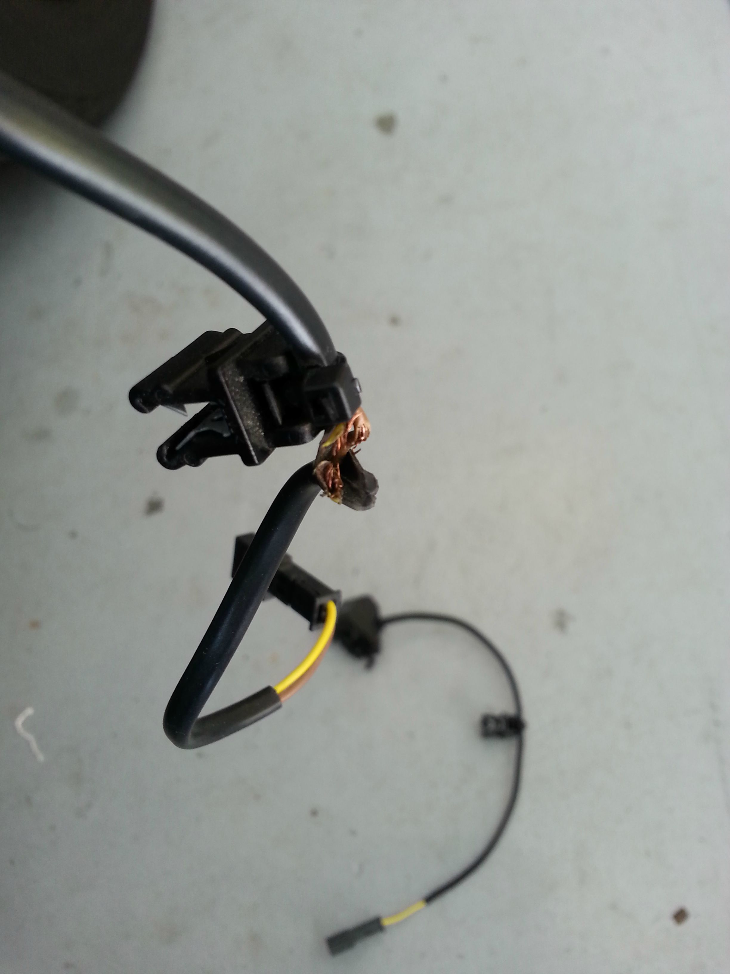

Here's how to change your seat position sensor. I was having intermittent seat belts and SRS lights on the tach and speedo and it persisted even after clearing the codes. Though sometimes clearing the code worked for a few minutes of driving then the lights would return. INPA told me it was the seat position sensor. I looked under the seat and could not see anything wrong with it but I ordered a replacement from ECS and set about throwing a little money at the problem. It turned out the sensors wire was broken and only held together by a slim bit of the wires jacket. They would occasionally touch and the warning lights would turn off.

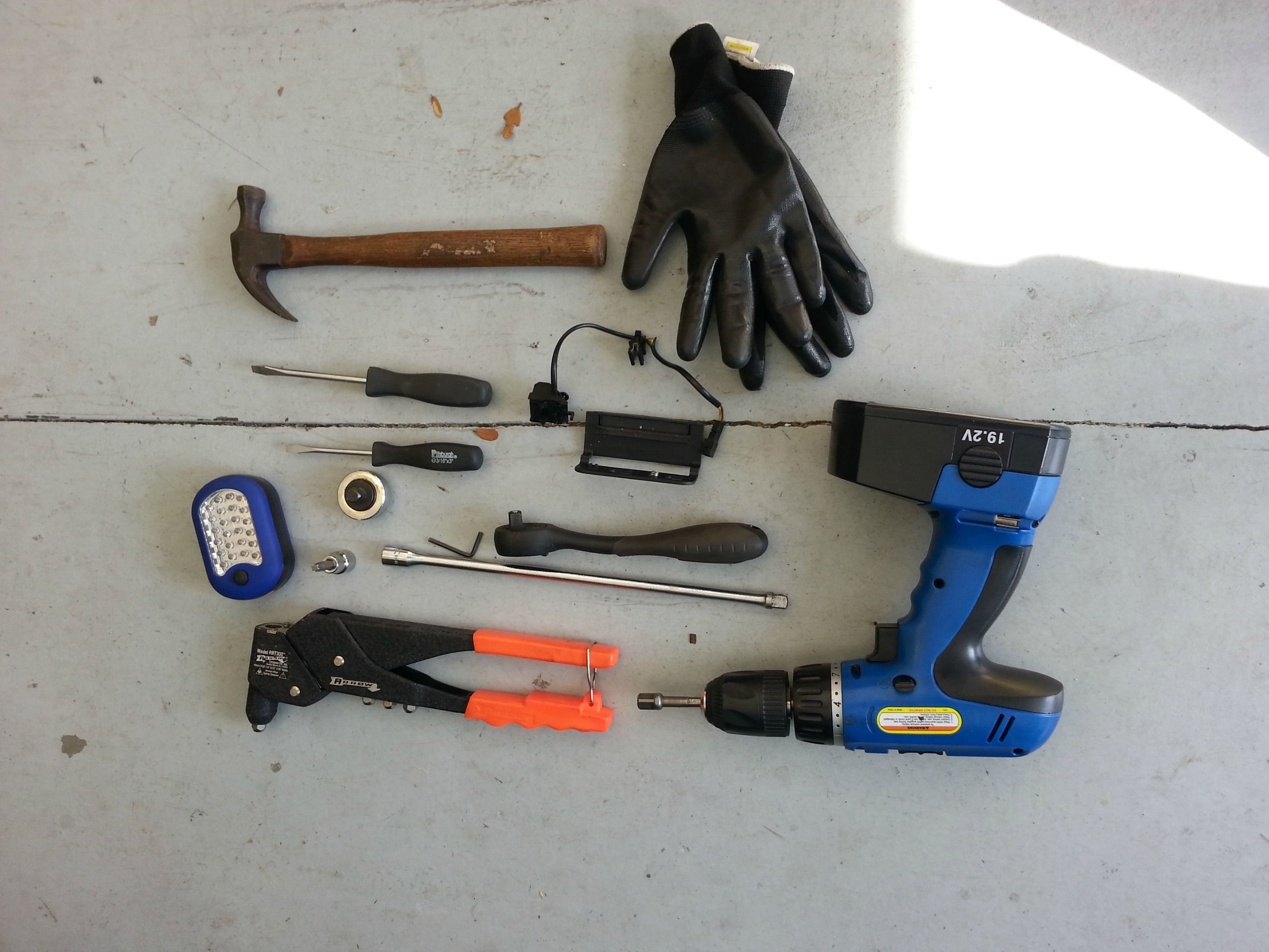

What I used:
Gloves (everything is sharp under a mini seat!), screwdrivers, T40 Star bit, Allen key (had to modify), hammer, pop-rivet gun, light

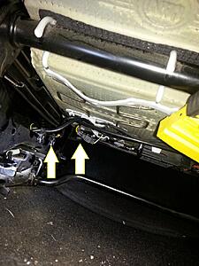

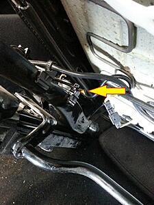

1. Disconnect the under seat wire connections and remove the 4 bolts holding down the seat. ***You may want to disconnect the battery before doing this operation.*** I choose not to disconnect the big yellow connector but to lean the seat back and carefully prop it to be sure not to pull that wire bundle.

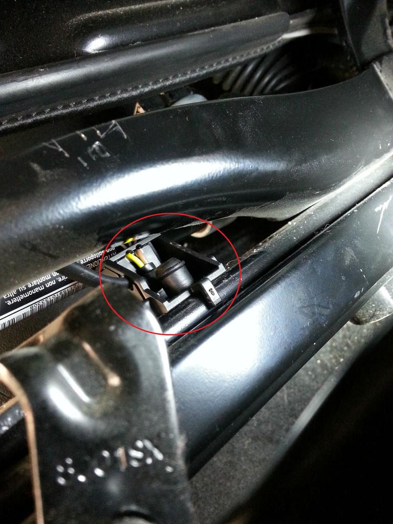

2. With the Seat leaning back against the back seats. Disconnect the electrical connector and cable restraint clip.
Close up of wire:

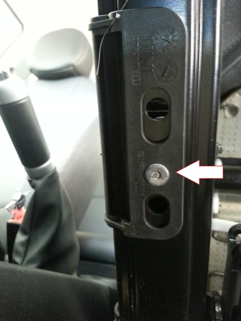

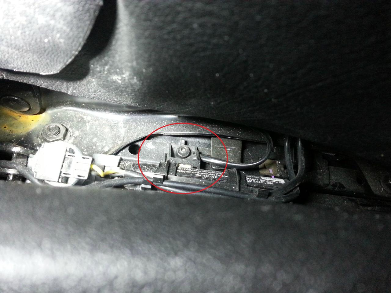

3. Using Allen key unscrew the singe Allen screw holding the sensor to the rail. Do this from under the seat. Replace the faulty sensor at this point. This is tight work and best done while you are in position. ***TIP: I had to cut about 1/2" from my Allen key to fit on the screw behind the rail.

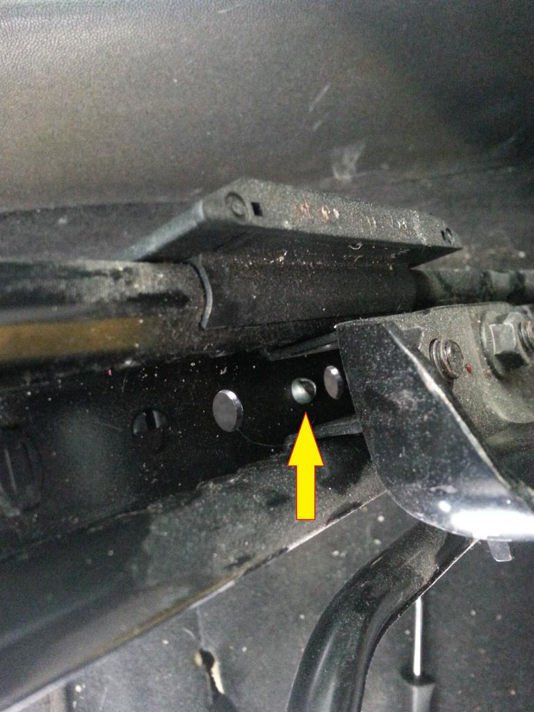

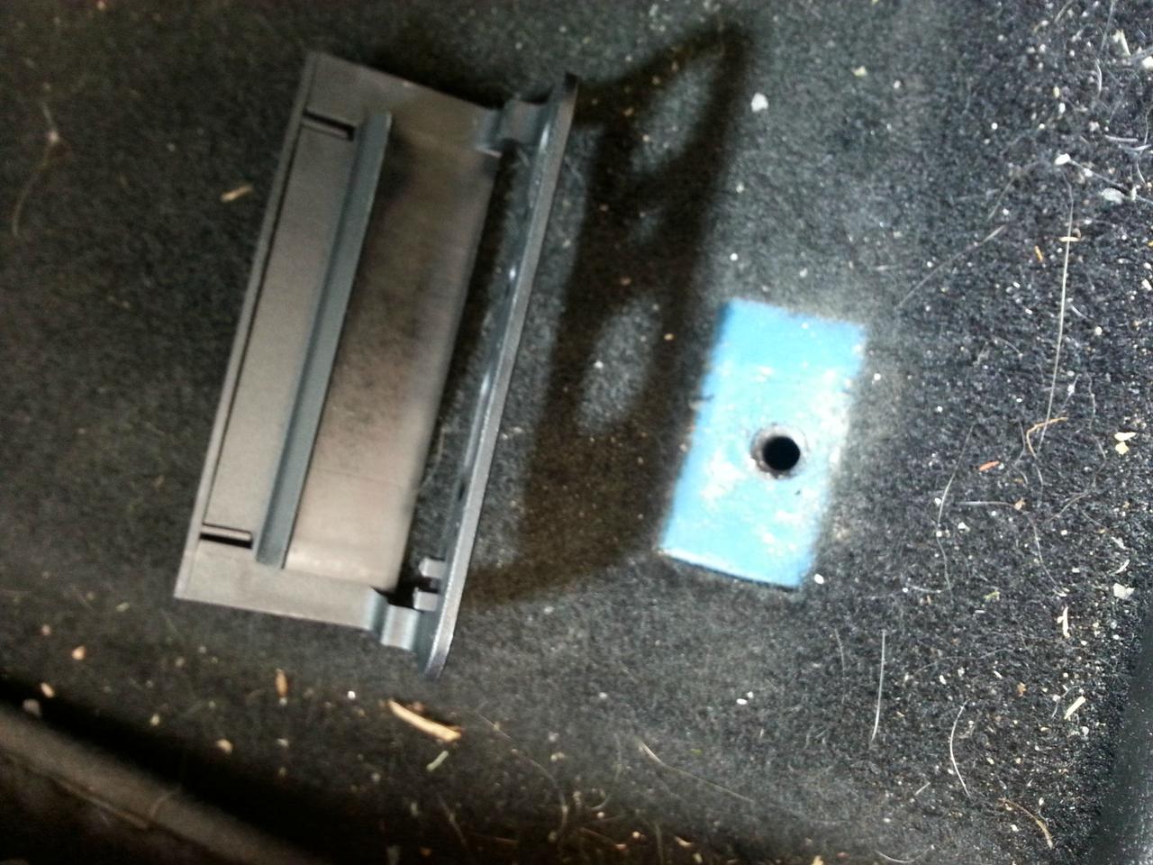

4. The magnet is encased in plastic and has a flat rivet on the bottom with its securing nub in the seat rail. Next using flat screwdriver and hammer knock off the rivet nub securing the permanent magnet to the seat rail.
Magnet
Magnet position
5. Clip the included new magnet to the rail in the same position as the old one and use your riveter to secure the magnet with the included rivet. The stem of my rivet didn't want to snap off so I had to use my rotary tool to cut it off.
