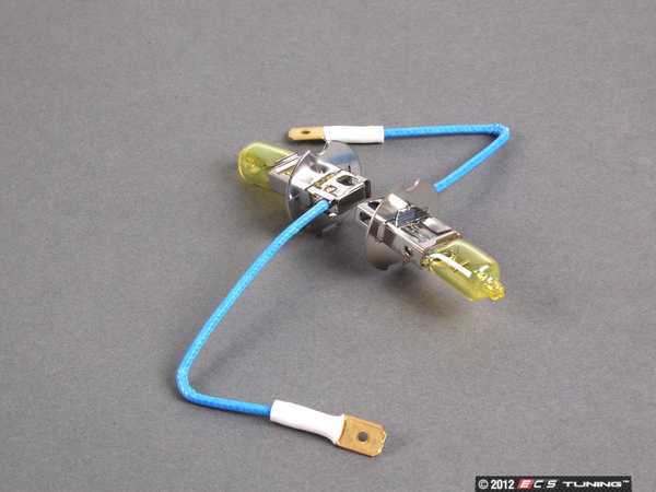

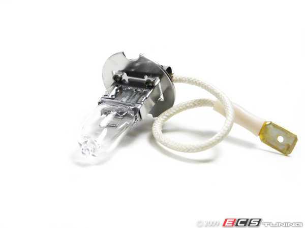

The standard size bulb for the additional driving lights or "rally lights" is the H3 55w.
Here is a picture of it:
http://www.ecstuning.com/Search/63217160779/ES174554/
We also carry the Ziza filament bulbs. Direct replacement.
http://www.ecstuning.com/Search/ZZH3BSPYA/
http://www.ecstuning.com/Search/ZZH3BSSWA/ES11141/
