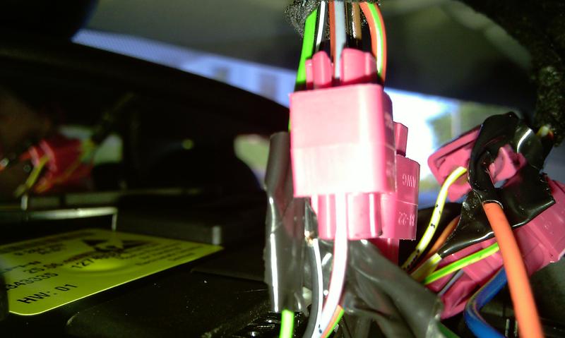

All set. After a little chat with KPN and testing using a voltmeter the module works fine. The only difference from KPN's instructions is that you need to connect your power wire to red/gray wire and not the purple/white.
