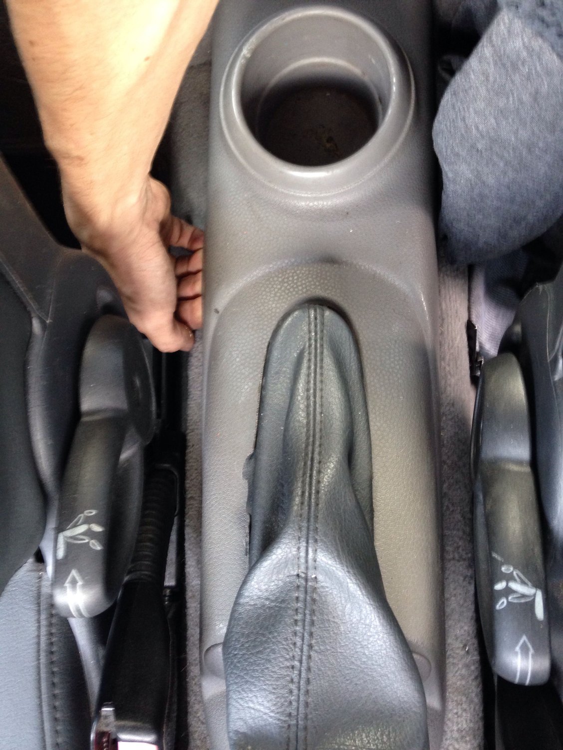

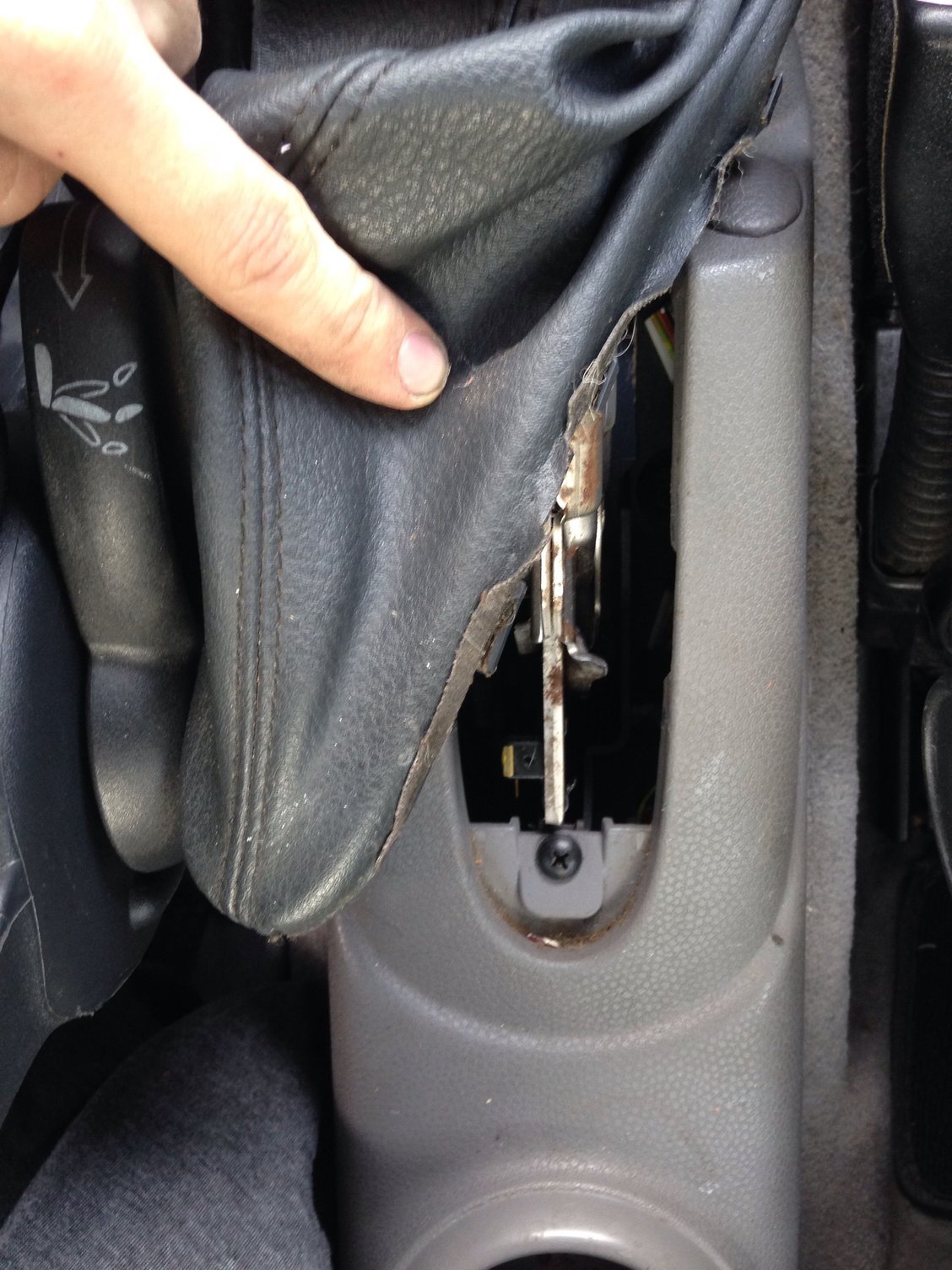

I have a similar problem and would like to know how to lift the handbrake console to access the switch please.
You have to pull fairly aggressively on each of the sides to pop the clips out. Squeeze the boot on the brake to get it off and make sure there are no screws holding it I. Before you pull. I believe there are 2 clips on each side but can't remember if there are screws.

Thanks, I have actually been able to unclip the part that holds the leather boot, but don't know how to get the rest of the plastic unbolted from the floor or whatever so I can get to the switch. Where are the bolts or screws?

The handbrake boot can be squeezed together on that trim ring clip and then pulled out. You can also use a small trim tool or flat head to pop up each clip on the ring. Watch out that front clip as it under flat.

Thank you again, however I need to reiterate that I understand how to get that part out, but it is the part that the ring is fitted to that I need to remove from the car to gain access and remove the switch.

Once you get the boot up with the ring attached to it. You should be able to reach and push up on the plug to pop it out of the hole. It has two metal tabs, one on each side that need pressed in to pop it out of the console with the plug and wire harness.

Thanks, will have another go, last time I couldn't squeeze my fingers in there. The photo in post #9 above indicates that the whole mounting part lifts off, but gives no details of how to do that.

Take this screw out
Then pull outwards on the sides like this to Pop clips out the. The whole plastic piece should come off.
Old Dec 10, 2015 | 12:54 PM
Posts: 36,762
Likes: 2,552
They lifter the whole center console on an 02' MINI , early design MINI have a center console like this below , button was in the front positioning towards the toggle bank area, in 7/2004 the TPMS button is on the side and further back in the console, as the console is longer. Diagrams linked below to take both types apart.
