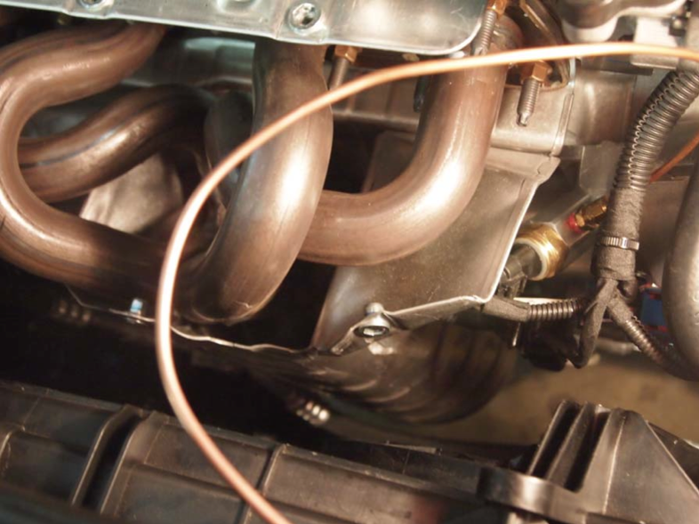

I've just finish installing my oil pressure/water temp gauges on my N18 and while installing the oil pressure sender was really a f**n PITA it was a tight space underneath the wastegate and oil filter. I bought 1/8npt to 12x1.5 male to female adapter,45 degree and extension fittings to relocate the oil pressure switch and aftermarket sender. I also use teflon tape to make sure there is no leaks.

I installed the CravenSpeed oil pressure adapter and sending unit sensor in my N14 using a hose from the adapter to the sending unit that I mounted behind the driver side headlight. I got the idea from a post here on NAM. I had Napa clamp on the ends to a lengthy of hose that I specified. I'd include some photos but I'm away from home at the moment.
