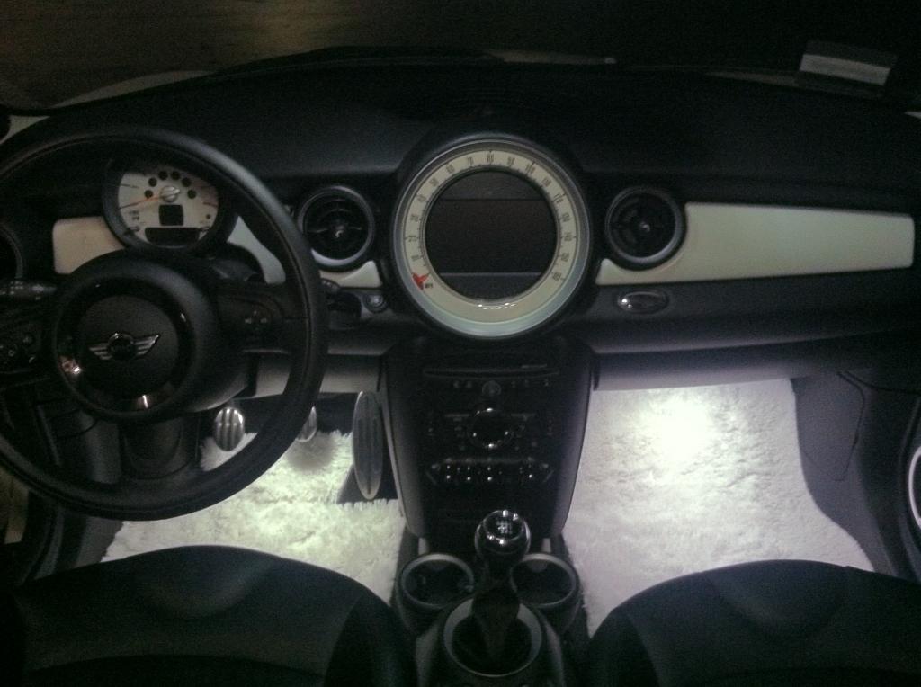

Some of the interior lighting mods I find most useful are LED strip on the underside of the boot shelf, and in the footwells (front and rear). Both were discussed in this thread: https://www.northamericanmotoring.co...light-mod.html

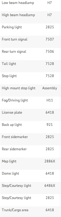

1st gen will use either T10s, and 36?mm festoons (for all the interior lights). i think you have a little "wiggle" room on the festoons, as you can simply bend the connectors if you get some that are bigger or smaller.
Here's a list of the sizes you probably have. I couldn't tell you for sure unless I was looking at the bulbs.

Another thing worth mentioning is how hard it is to light up a black interior. You'll really notice this if you end up with dim bulbs. Look at the wattage of your bulbs, higher is definitely better. I've also found that, typically, a bulb with 100,000 LEDs on it aren't going to be as bright or reliable as a bulb with 10 big LEDs. I have these in my fog lights and they are incredibly bright for LED bulbs:
