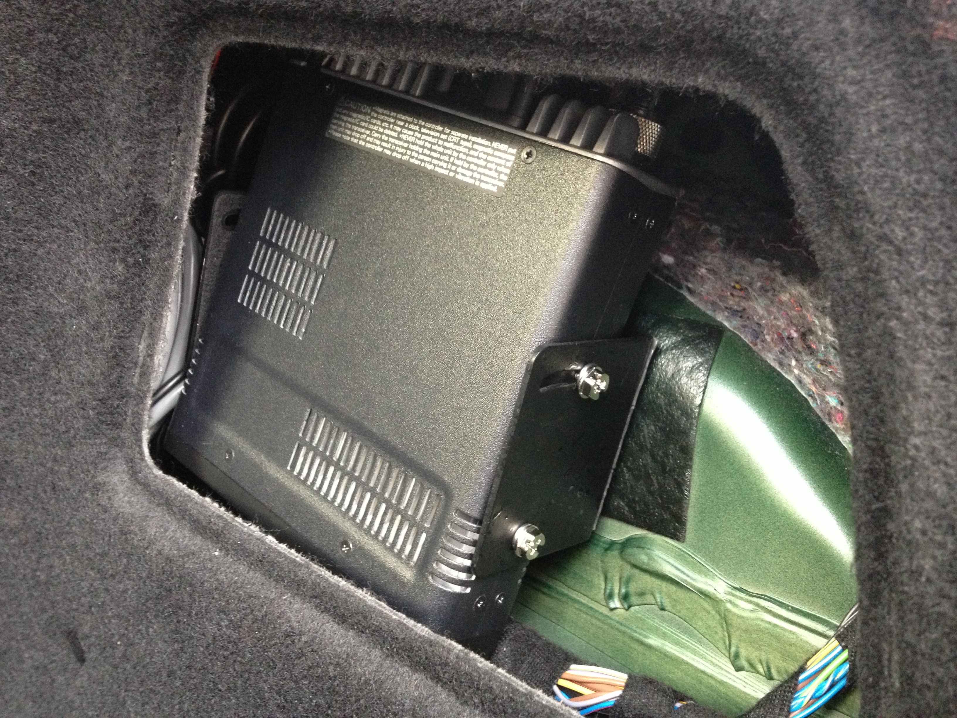

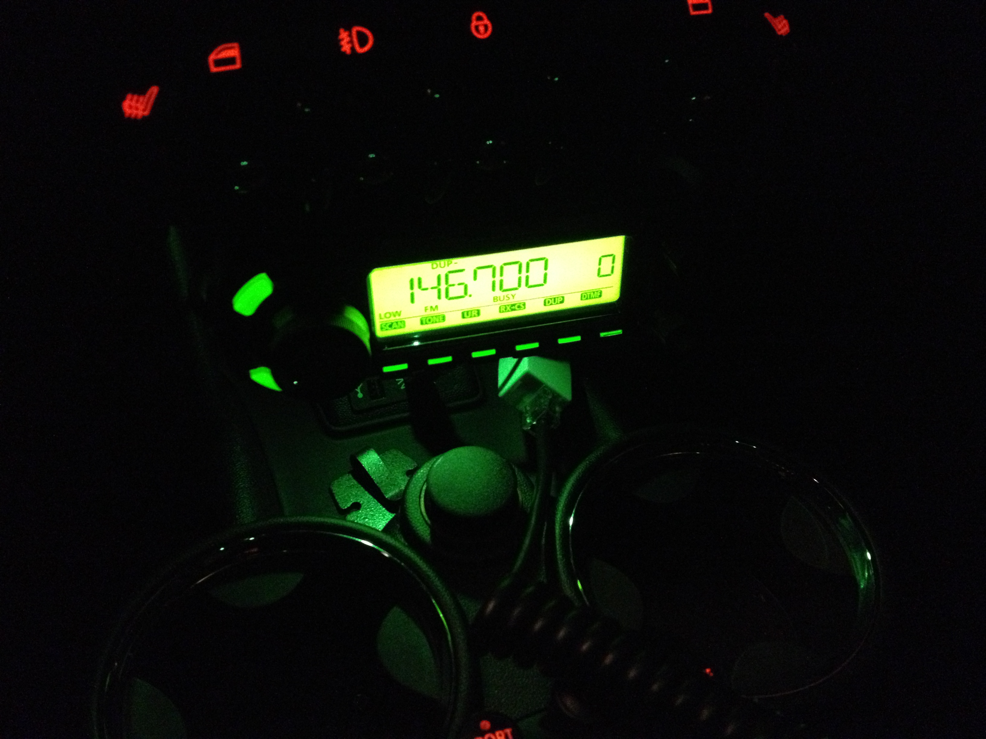

Alright, just got my ID-880H installed in my '13 Mini Cooper S.
Ended up running power direct to battery, ground wire does not need to go there as there are ground lugs in the lower paneling below the doors that are designed for these types of connections (found instructions for this on an installation manual for a sub amp for R56 specifically).
Radio is stored in rear compartment, mounting bracket secured with 3M Automotive trim mounting tape (super strong) That radio is definitely secure.
Antenna is a Larsing through glass dual band antenna mounted on the rear passenger window (works surprisingly well).
I did the same thing as the previous guy mentioned, routing most of the wire down the passenger side. I opted to put my mounting face in the lower area in front of the cup holders.
As far as external speaker, I ended up routing auxillary cable up to the front aux jack. It works fine if radio volume is kept low (not ideal). I'll be putting in a little attenuator circuit in here in a few days to eliminate that issue.
Signal is clear, no whistling from the antenna (as some people reported with this particular antenna), and there was no tuning necessary.
