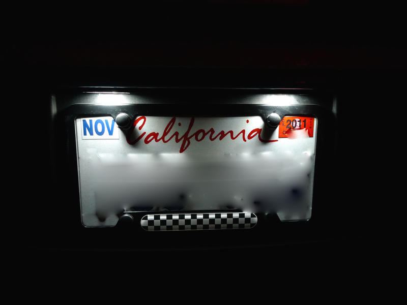

WeissLicht LED
Walk0080,
Yes. IMHO, it is worth paying the premium price. The light assembly fits perfectly on my Clubbie. I had them for couple weeks now and so far, no "dash error."
The LED lights are very bright and no issues with lights flickering either. Here's couple photos:
Originally Posted by walk0080
I've been looking at these:
http://coopersport.ca/56/LPL/
WeissLicht LED License Plate Illumination Upgrade
Wonder if they are worth the price premium?
Attached Thumbnails LED License Plate Lights...-led1.jpg   LED License Plate Lights...-led2.jpg
