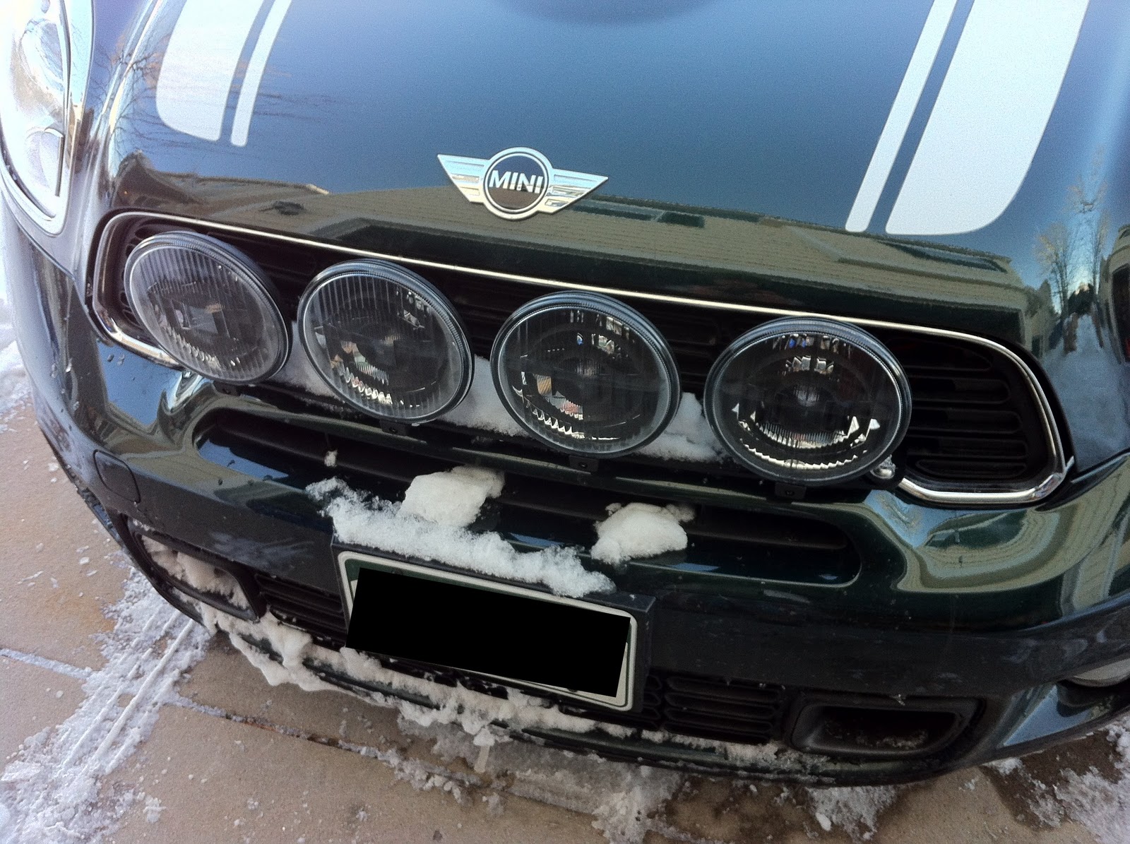

Got my lights installed, connected up to the fog button. Still need to install the override switch (snow followed by a vacation has made project completion a bit more difficult). I like the mounts, makes the front look a little more angry (at least I think so).

The 4 light rack looks incredible, I'm looking to do the same on my Light White CM. I'd like to buy just the lights though, and make my own bracket, does anyone know if its a special 4-light harness, or is it just two 2-light harnesses that you splice together at the end?

There isn't much special about the wiring for the lights, just some extra taps on the driver's side for the lights to plug into.
