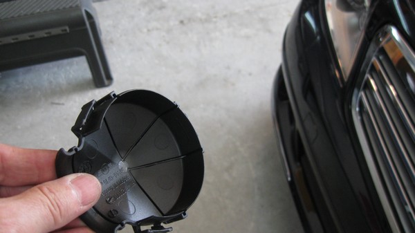

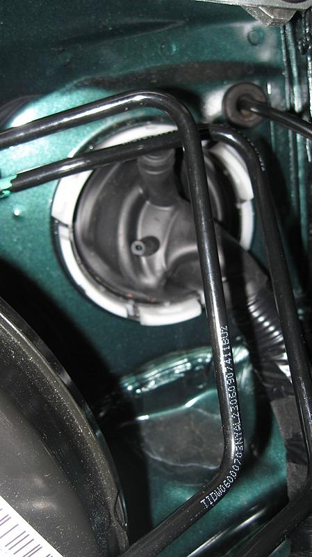

Here's what the cover looks like off of the car, and here's what's underneath it.
