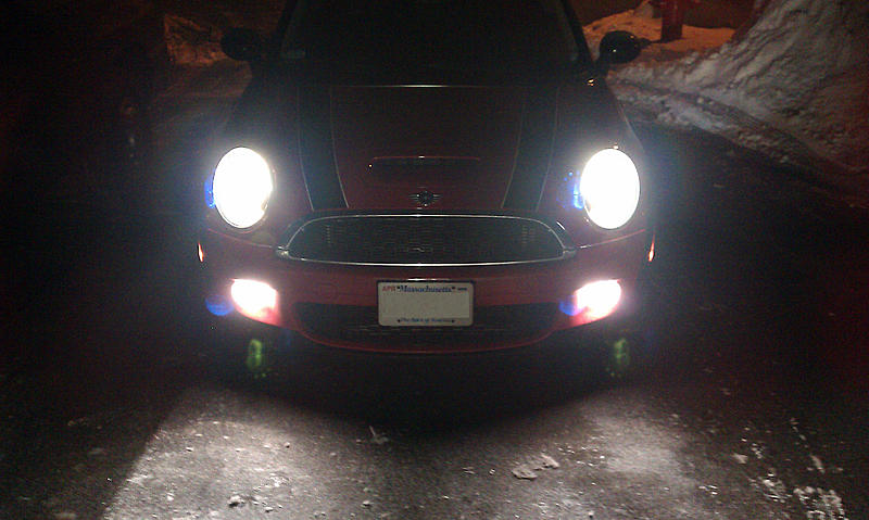

Forgot to add my crappy cellphone pic to the collection!
Def, take the connectors off and twist, the drivers side was the hardest for me because of what ever tank the connectors are close to. Not a lot of space to grab I thought.
