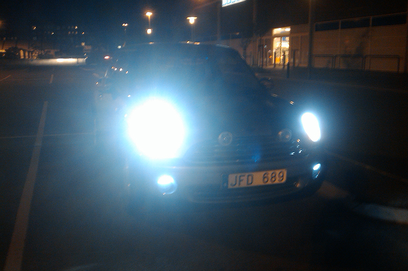

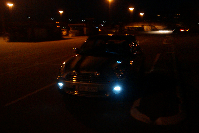

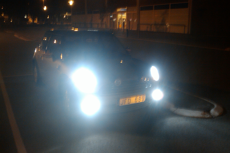

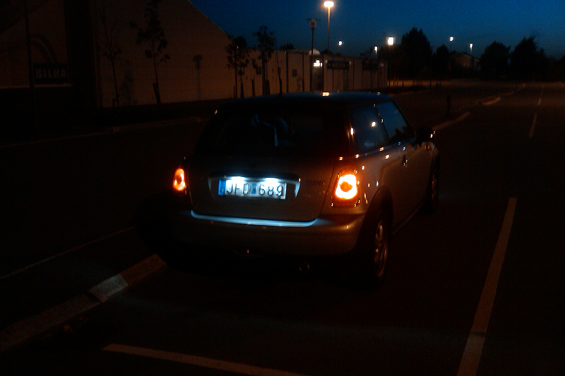

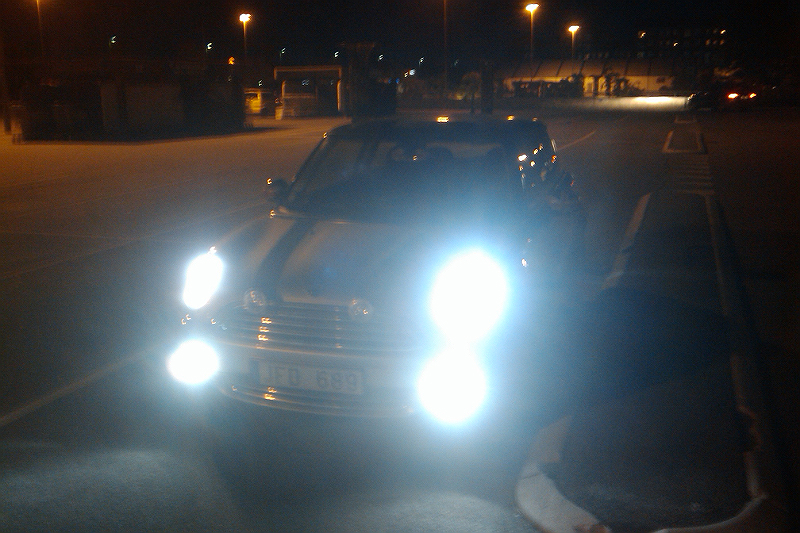

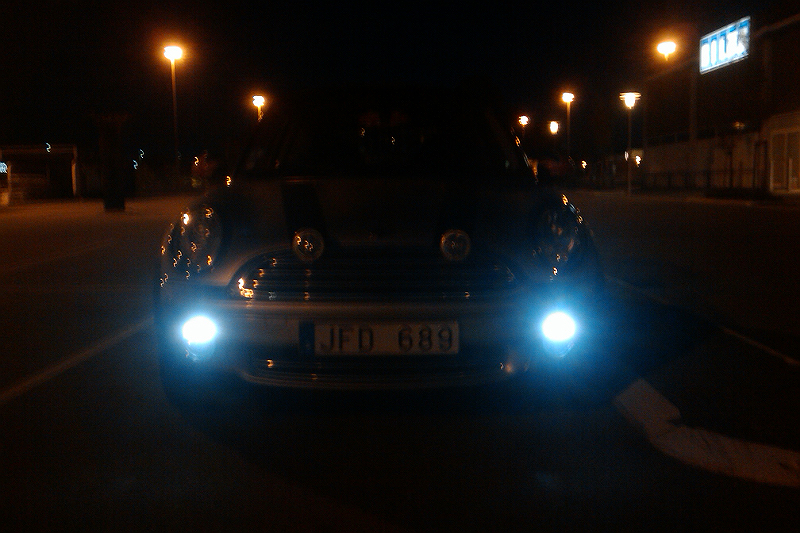

Pictures of my Mini with Bi-Xenon in Halogen Housings!
Here are some pics, that you requested...
PLEASE dont comment my ugly ugly driving lights.. I have never regreted anything so much in my life, than these lights i bought from EBAY.. The so called: Halo Lights - I feel so sorry for my mini - I didnt knew that time, so much about minis. Now i know a lot, and i also know where to buy the original ones, what size they really are, AND where to place them! I know that these ugly halo lights are toooo high on the grill. F****** EBAY SH**
And by the way, they even RUST!!! There is RUST ALL OVER THE BRACKETS AND SCREWS - A little tip - If anyone want to buy these halo lights "for your mini cooper" DONT DO IT!
PS - Took the photos with my mobile phones. Sorry for the quality!
enjoy

OKAY NOW I HAD IT!!!
IVE STILL HAVE THE BUZZING NOISE AND STILL HAVE THE BULB OUT WARNING!!!!!!!!!!!!!!!!!!!!!!!!!!!!!
IVE SPEND TO MUCH MUCH MONEY IN THIS!

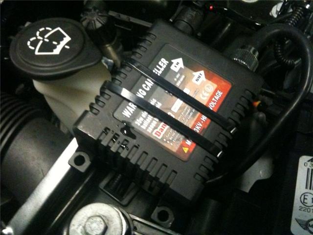

I received these digital ballast with built in warning cancellers today:
http://www.hids-direct.co.uk/hid-bal...ast-p-337.html
Like PRIMINISTAR said this would work. But sadly NO!
Ive really gone insane.. I installed these (Just replaced them with the old china rubbish ballast) and STILL GOT THE BULB OUT WARNINGS and BUZZING NOISE when going to HIGH BEAM!
I AM SO MAD!! Like i said ive used to much money and time on this to get the perfect kit /setup but no...
SO i decided to troubleshoot a bit!
When they engine is NOT started, the buzzing noise do not appear when going to high beam.
When the engine is STARTED the buzzing noise of course appear when sat to high beam. I then decided to let my ears go after the buzzing.. and to me IT REALLY sounds like its coming from the relay?! I posted some pics of the relay.. COULD THAT BE IT?! shall i buy a new relay from HIDS DIRECT?!
I also noticed that it is only the right bulb that is vibrating a bit with the buzzing, when high beam is on. (the relay is also mounted on the right side)
BUT BUT BUT.. THE MAIN PROBLEM IS.. I STILL FREAKING GOT BULB OUT WARNINGS! HOW COME THAT BE?!? Can this have something to do with that i have a loose wire with no H4 bulb in it, in one of my halogen housings?!
I simply followed the HID installation instrucs...
Any help?
ps check pics
