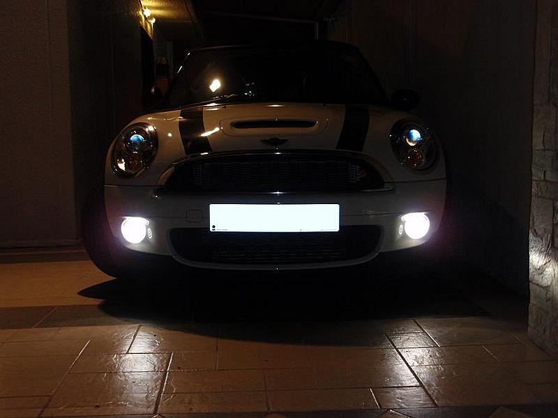

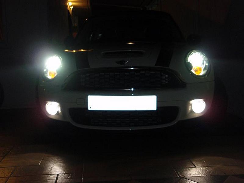

i just bought those 5w regular with label of bright white...and also changed the fog light to higher K, but not high enough...here some pics
nice! yea, i'm in the same boat- i installed my xenon look fogs @ 6000k, but they are still a bit less white-blue than the xenons (tho much better than the yellowish original halogen ones) Im' going to do hids soon, maybe 3000k for a bright yellow. my LEDs are like white-blue though, so i'll have to see what color combo i want to go for.
Those still look a lot better than stock. Any link or more detail to the bulbs you're using?
