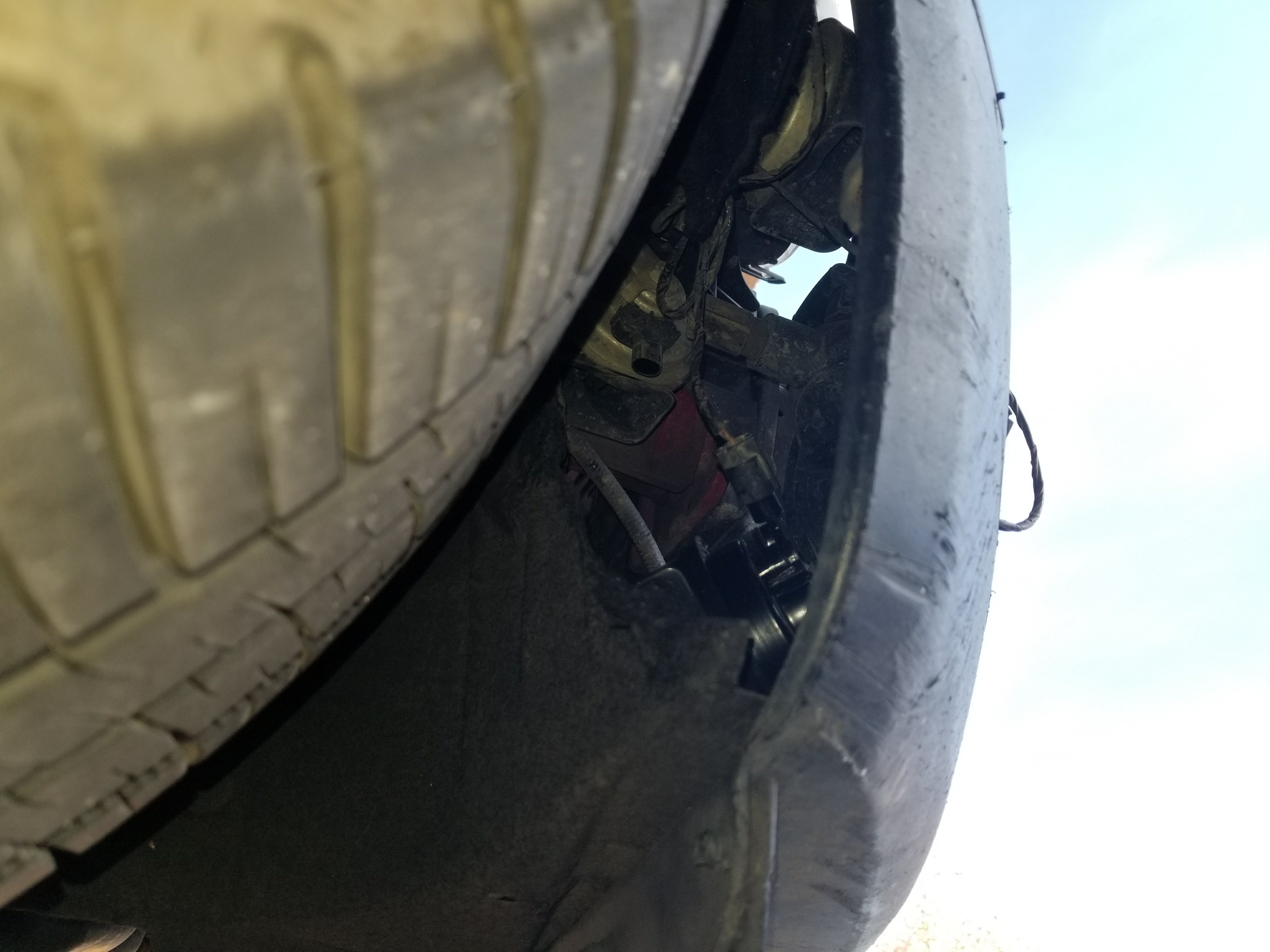

OK...well I found the second one...right near the 1st...yeesh. What thru me off was an image I found of an R53 with the horns on opposite sides of the car.
Instead of taking the bumper off, I reached up behind the bumper (see pics...I'm laying on the ground looking up and forward with my head right beside the right front tire...yes, part of my wheel well liner is gone from some road debris I hit a couple years ago...that said I think I could have bent it out of the way if it was undamaged)..and thru there was able to remove the wires. I left the old (broken/silent) horns in place (as I'm assuming the bumper HAS to come off to remove them?)...and just wire tied the new horns so they don't flop around.
I bought these Hella 012010881 horns...they are plug and play, sound good, and are cheap:
https://smile.amazon.com/gp/product/...?ie=UTF8&psc=1
