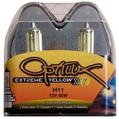

For the fogs, I chose Hella H11 Optilux XY bulbs (Extreme Yellow). My eyes are sensitive to glare, so I need all the yellow light help I can get in bad weather.
http://www.amazon.com/Hella-H7107113...6786610&sr=1-3
For the fogs:
- turn the wheels out on the side you're going to work on
- unscrew and pop out the 4 phillips head clips in the inner fender liner.
- - they look like (i) in the picture below
- - if they just spin instead of unscrew, just put a little pressure on the base with one hand while you unscrew with the other
- - once they are unscrewed about 3/8", you can pull the whole clip out.
- unsrcew one phillips head screw that's under the bumper and screws up into the fender liner
- now pull back the fender liner
- reach in and unplug the wire harness by squeezing the connector from the edges toward the wire end, and pull
- rotate the bulb counter-clockwise 1/4 turn and pull it out.
- install the new bulb and reverse the procedure

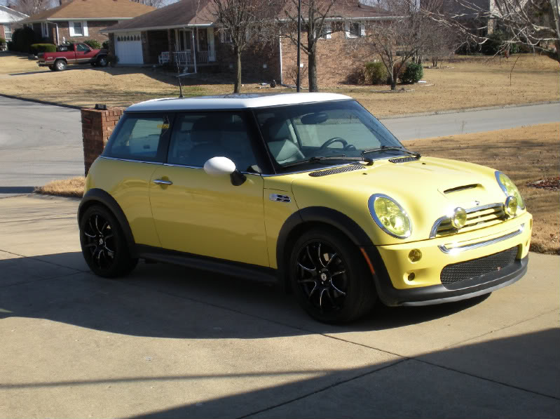

LaminX sells films for every OEM light on the MINI. Check out my R53. You cant really tell that the fogs are yellow because of the recess(Which made them a PITA to put on). They are not over-the-top when it comes to yellow like tinted bulbs. Here in Arkansas, the only headlight law reguarding color/tinting/etc. is that "light emitted from headlights must be yellow, yellow-white, or white". I love the Rally look that the tinted lenses gives.

Dang, you like yellow! haha, well I'm just interested in that "cool" appeal at night when they're on. Can you tell that they're yellow during the day?

Ahh, if you're looking for the lights to be really noticeably yellow, the Laminx might not be for you. My lights look yellow, but It's not something you really notice with the lights on. Except the xenons do look a little green.
