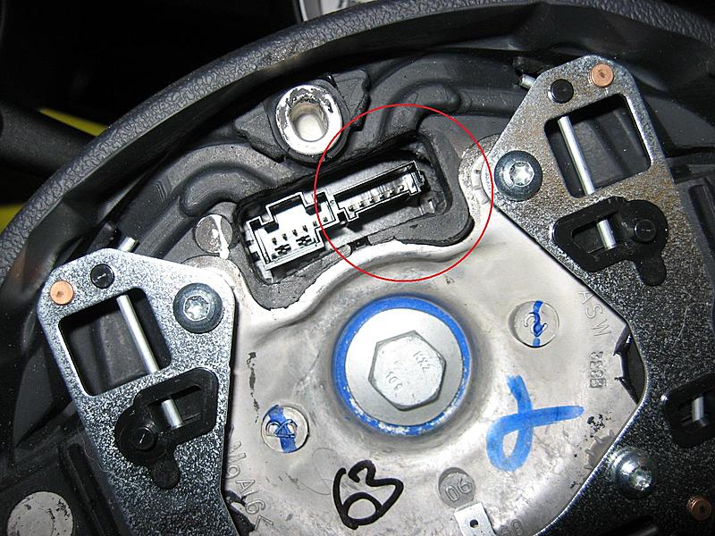

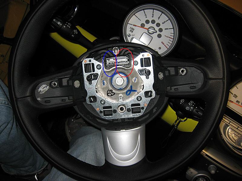

OK everyone. I finally got a chance to get to the inner guts of my steering wheel.
I have a 3 spoke steeringwheel without Multifunction. There was a debate if you could add Multifunction Switches to the steering wheel if it does not have it.
I took my airbag cover off and the L&R Cover plates where the Multifunction Switches would go and there is pre-installed in the steering wheel a Male connector for the Multifunction switches!!!!!
I am going to order the Multifunction Switches from MINI and install them and then have my Local Dealer Re-Program the computer so itll activate it. Exactly what someone else did as well and it worked. I just wanted to verify the male connector was pre-wired.
Here are some photos of my steering wheel. The Connector Circled in RED is the one for the Multifunction Switches switch. The one circled in BLUE is what the Air Bag connects to.
I will buy this part number 32306773645 it's #2 in the diagram from RealOEM.com then I'll have cruise and radio controlls.
Attached Thumbnails Multi Function Steering Wheel-img_9601.jpg   Multi Function Steering Wheel-img_9599.jpg   Multi Function Steering Wheel-235.jpg
