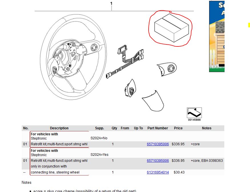

Old Sep 21, 2015 | 12:45 PM
  #80
Norton70's Avatar
Norton70
Joined: May 2015
Posts: 44
so what is the box / module displayed in the retro-fit kit? (see attached image)
http://www.realoem.com/bmw/enUS/show...diagId=32_1584
Attached Thumbnails Multi Function Steering Wheel-retrofit-kit-and-module.jpg
