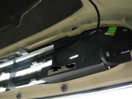

Laser Blinder Install
...to contribute smth back to the Community here :-)
After getting a speed ticket (from a laser-gun-equipped officer) I decided to take measures.
Radar (which I have installed anyway) does not do any good against laser, so I did some research and came up with the idea to install Laser Blinder (http://www.blinderxtreme.com/) on my Cooper.
This thing is actually legal in Texas and few other states. What it does is it emits infra-red to confuse the laser gun and prevent it from locking. It also detects the gun so you can slow-down, switch the blinder off and let the officer measure your legal speed ;-)
The challenge here was to find a spot in front to install the 2 emitters so they will be effective (close to the headlights which the laser beam is usually aimed at) and stealth.
What I eventually did was to cut out the 2 plastic inlets in the grill and put the emitters in there with the supplied mounts and a little of plastic drilling to fit, running the wires between the hood and the inside hood cover, through the firewall hole and into the cabin.
See attached photos and enjoy :-)
Much more relaxed driving now and no tickets (knock on wood) ;-)

How much was this thing? and did you install it or did a pro do it?

this was about 300$ and I did the install myself (I would say it was as easy as installing aftermarket driving lights).

The thing about laser jammers/deflectors, is that they have to be right where the laser is aimed. "Usually" the cops aim for the license plates or headlights, but not always. So...... the question is, "Is it worth it?" As we all know, if a cop uses instant-on radar, a radar detector is supposedly "useless" for giving advance warning. Nonetheless, my experience has been, if you slow down once detected, and weren't driving like a loon to begin with, they will find someone else to go after.

from what I remember the jammers/emitters need to be installed within about 1 foot of the headlights/license plate to be effective (they cover a "cone" of about 2 feet in diameter) - no problems with the Mini in this regard, much less real estate to cover in front that a F150 ;-)
For instant-on radar - do not have a cure for this yet, but the local cops use laser guns mostly.

Excellent job on the install. There are others with blinders on their mini as well. Unfortunately their transceivers are a bit too tall for the mini grills so they require some cutting or grinding. I have the bel/escort jammers which are thinner (but wider) and just fit in between the grill slats so they were much easier to install. And in case you are wondering, they work very well.

I have installed one of these on my car! its been there over a year! I have the ablitly of testing these. I can promise you if you install down in the front grill a it will provide plenty of protection, if you dont have the front plate on it works even better! but it will work with the front plate on as well. These are great machines!!!
