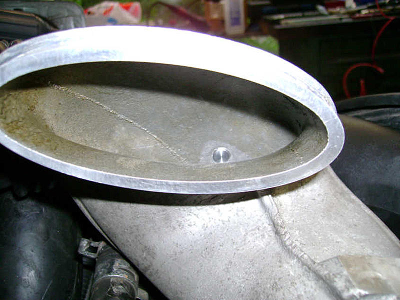

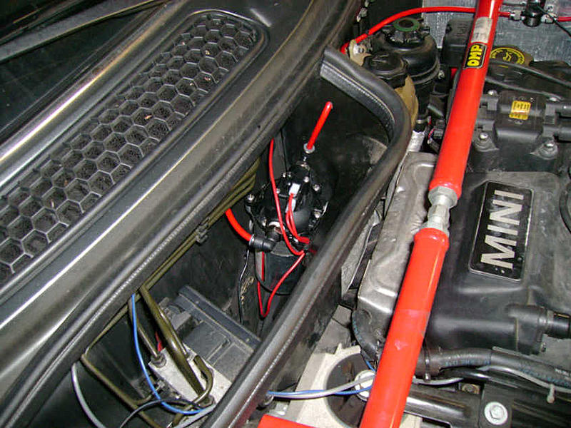

Here is my installation, GP intercooler and W&M injection post IC with a 175 ml nozzle.
Quite important is to use a checkvalve cause of the ijection behind the throttle body.
Without the valve in suction condition, the vacuum sucks the water into the engine.

MadMick: Nice photos of what looks like the basic system that I described. Did you do any dyno tuning?
