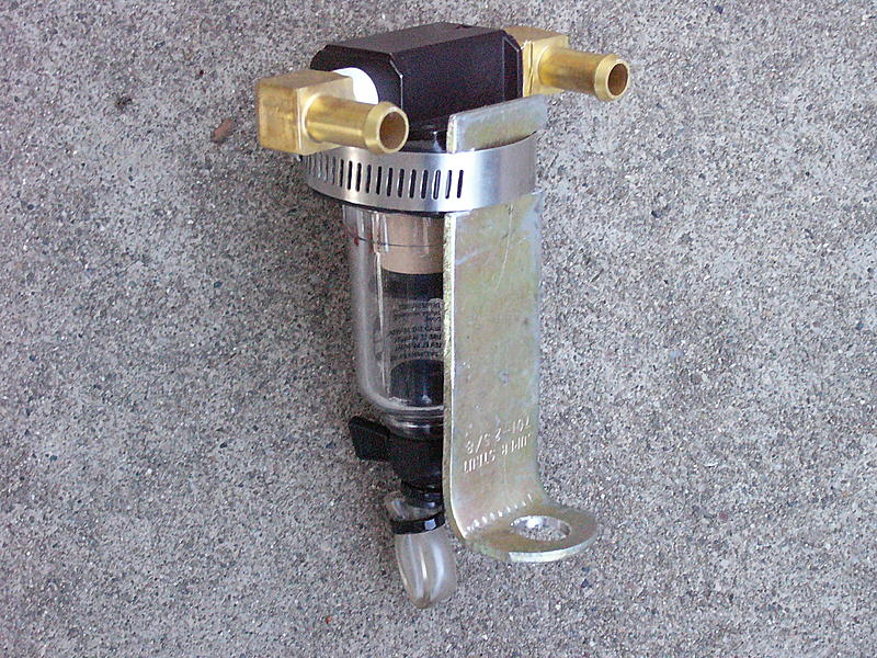

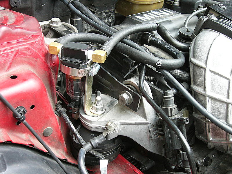

Home depot oil separator
I wanted something small and cheap so I put this together. The "bracket" is a pipe strap I had in my miscellaneous junk heap which I "straightened out" and hand filed for better hose clamp fit. The Home Depot oil/water separator has a little drain valve at the bottom but it was easy to open and close so I used some tubing to zip tie closed. I did not have to butcher the factory tubing so it is readily reversible.
I originally had it mounted square to the engine mount bracket but found that there was interference fit between the top of the separator and the headlight washer device, so I pivoted it a little. I also filed it down a little and used magic marker to bring back the black. I used some playdo in plastic bag on top of the separator and squished the hood down on it to make sure there was enough room. There was. I know the engine will rock a little so I am hopeful that the hood will not develop a ding. It should rock forward and down under acceleration.
Not counting tools the parts are about $25.
I had to get an E12 torx external bit (snap-on $11.00) and 18 mm deep socket (sears/Osh $8)
Then the quandry about what to clean the intercooler with. I declined the usual hydrocarbon sprays which all said to dispose of in accordance with federal, state and local laws and regulations, and prohibited disposal the way we always dispose of such stuff. I bought "purple power" from Kragen, which is ostensibly "certified biodegradable product" $6.00 the 40 oz container. It uses hand power instead of propellant and is useful for home as well. The Intercooler came out real clean. I noted that it is time to get new intercooler boots, though. My Mini is 2003 with 58,000 miles.
I'll see how it goes in terms of oil accumulation. I noticed that the intake side boot (larger) had oil in the groove and the outlet side boot was dry.
Attached Thumbnails Installing an OCC-p1050171.jpg   Installing an OCC-p1050193.jpg

Is that fuel line going to and from the HDOCC?
Old Apr 6, 2008 | 07:28 PM
  #143
SteveS's Avatar
SteveS
Joined: Dec 2002
Posts: 551
From: Santa Ana, CA
I simply interposed the HD fluid separator between the valvecover and the line going to the intake tract. There was no change in the stock line routing.

I know. I didn't say the fuel line; I said fuel line, as in the type/grade/labeling of line added between the valve cover and the intake tract. The path is obvious, but I was curious as to what kind of tubing you added. However, I can now see from what is printed on it that it does indeed appear to be fuel line.

after you've run it for a while and see what you collect, try putting some filter material in there and see if it collects more. I found that to be the case.

The Home Depot "separator" has an internal filter built into it.
