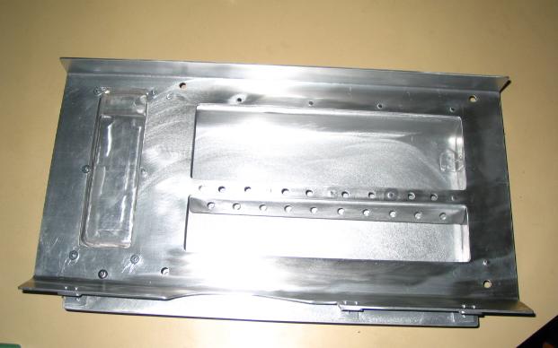

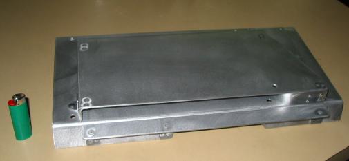

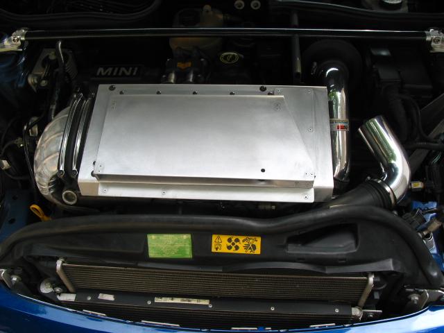

IC mod
Ok here you go. The finished proto. And, so far it looks like -8 -10f gain over stock. There are a couple of seals that need to be made so there may be a couple of -degs to go. More pics in the next post

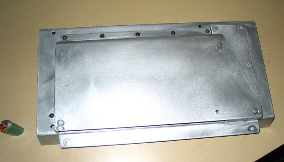

The lighter is for scale.
The under hood temps seem cooler since the bottom of the plate is open. It is in the mid 70s today however on cold days, low 30s, it still gets pretty toasty under hood.
I'll need to run some 30-40mph and 60-80mph tests for under hood temp. I have an Alta diverter on the way to do some side by side next week.
For now, it looks like it's working well.... For $12 worth of materials & 8hrs.....

Nice
Took me a bit to figure out the hole in the top
