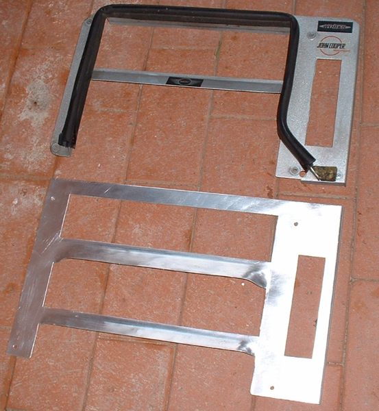

I have fitted an ALTA large intercooler with the air diverter that comes along with it. As I am not happy with it scratching under the hood too hard I first modified it and now I am doing my own design which is slightly different.
I don't have much spare time, but when I have finished it somewhen in the future it might be interesting if it would make any diffierence in the intake temperature at all. For sure I will post my results here then ...
Picture shows original ALTA diverter and below my design (not finished yet).
Ooooh. I like your design.
Any plans with management of air that flows over the right side?

Update...
Well crap... I ran out of solder... have to pick some up tomorrow.
Here is where I got to... just have to finish the perimeter walls and I'll be all good to go.
You know... bending sheet metal into a half circle... is a real pain in the ****...
Nothing special. The sealing between diverter and hood will look similar to the attempt from GRS-Motorsport.

Getting closer...
All the walls are up... now just putting in the foaming to seal to the bonnet... stupid 30min epoxy.
