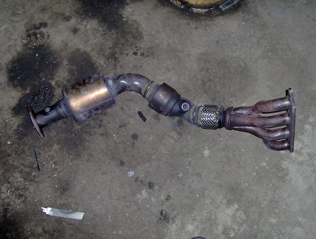

here is a picture after i welded it back together
cheers

I thought we should cut the section below and weld it back with a pipe. You can see that the pipe size is smaller at the sensor hole area.. and i think that area should be removed and replaced.

yes, i agree with that, what i am doing is one thing at a time to find what works and what does'nt work. i hope i can find another stock header to to make a straight piece to replace the whole run between the flex joint and the main cat, then test it against this one. this header looks 100% stock, i would like to see the smog police find that this stock header has been tampered with,it would take a x-ray to find that it has been altered. this thing fits perfect, basicly the same sound level, and makes better power. i will post pics and results when i do the next one.
cheers

Make sure to take good pictures and remember what you do because I'm probably going to want to copy you. It doesn't help that I can't visually tell the difference between the original header and your modified one.

Isn't that the point?
This round is the totally stealth, undetectable by inspection, low cost exhaust mod!
The little doo-hicky is gutted! To use the technical term....

Okay, I just thought that it was undetectable by state inspectors. I mean what do they know about Mini parts? The manifold being gutted makes sense now.
