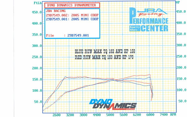

Originally Posted by JeffS
Doesn't seem likely since HP is a mathmatical derivation of torque.
Torque * rpm/[a constant] equals hp.
This means that torque can go up SIGNIFICANTLY, lower in the power band [low rpm], and still *peak* hp would be unaffected whatsoever. See R1 Kid's dyno below... This is what we sometimes fail to notice on a dyno plot. With the MCS's, torque stays nearly flat from 3k rpm on, I believe. HP continues to climb, though, because rpm steadily does. Now, if the TB added 10 lb ft torque down low, from 60-70 lb ft [both just hypothetically], at a given rpm [like 3k], you would not notice much of an hp difference. HP would climb like 1/6 higher, but it still would not approach the peak number, so the peak number would not change. Remember, our rpms can go past 6k at the high end, which is twice the factor used at 3k, so at 6k, you'll see nearly twice the hp number. Simply doubling your rev count with a flat torque curve has an equivalent hp effect as does doubling your torque at any given rpm. Peak HP withstanding, though, you can see a significant change in torque lower down, and this kind of torque you will feel.
What L8rg8r is relaying is a noticeable improvement in low-end torque [proportionally more air flows through a semi-open TB at lower angles - that much is geometry...envision the difference in area contained in the outer 1/4 of a circle versus that in the inner 1/4]. It is there for anyone who drives with a larger TB to see. Don't criticize him...he's right. I noticed it myself with my 62 mm, although I couldn't fully isolate the precise effect because I added more parts at the same time. Rally is right, too, because throttle response is MUCH better with a larger TB. It's like lightening the flywheel, but I hesitate to state how big of a difference it feels like. I will be as objective as possible.
Use R1 Kid's recent HAI dyno to see these words transformed:
