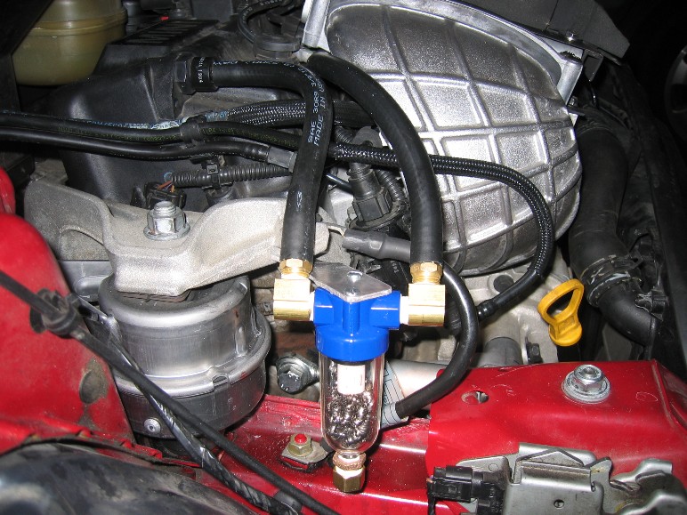

I just added this low cost OCC yesterday. Took advantage of all the prior advice: the intended inlet is actually the outlet, cut off the bottom of the internal filter, and put a piece of a stainless steel scrubbie inside. On OldRick's recommendation, I bought 1/4" ID fuel line, but I don't see how that would ever fit on the PCV or the gray tube, so I went to the usual 3/8". To make it easier to drain, I drilled out the schrader valve at the bottom and added a bushing and a cap. That way I won't be wearing out the plastic threads.
The IC was actually dirtier inside than I expected. There was some black gunk in addition to the oil. I think the oil-coated IC functions as a 2nd stage air filter -- any dirt that gets thru the first air filter is trapped in the IC!

Nice job inimmini..............a simple do-it-yourself mod that is cheap to try. If nothing else.......it gives you an excuss to take the intercooler off and see what's inside.
My catch can is holding up just fine and although I don't get much oil in it, I think that is do to my style of driving. Will see what develops after the 16% pulley install that I am planning on doing.

Yes, I went with the 3/8" lines as well, they seem less likely to kink and more likely to flow.
I put this all together yesterday, took about an hour including the shopping and it seems to work well.
Have had some problems with fitment and my Xenons. Attaching point are different than in your original picture cause mine is an 2002.
But, altogether an great idea and an inexpensive mod!
