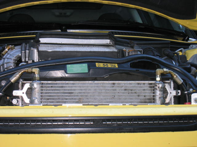

Good morning. This hot weather and track days does make one think of oil cooelers, doesn't it? I have installed an oil cooler system using the Maddness adapter plate, a modified MINI CVT transmission oil cooler radiator, and custom industrial hoses. No fuss, no muss. No instrumentation so I don't have any performance measurements. Here is a photo.
Regards,
John Petrich in Seattle

That's very trick John Did you fabricate the brackets?

A cool thing about the CVT oil cooler approach is that all of the bracketing is stock. All I needed to purchase was a single small machine bolt to install in the stock clamp. The stock CVT oil outlets didn't work for me, so I relocated the outlets and installed AN-8 connectors. The particular hoses and clamp on fittings that I chose are bulky and clearances are tight.

John, was that a lot of custom work to relocate/install AN connectors...ie, welding required?

The rework of the CVT oil radiator does require welding and not soldering. I'm absolutely paranoid about a solder joint failing under temperature, pressure and vibration stress.
I think the stock oil filter assembly incorporates some sort of a thermostat ! I'll tell you why: Since installing the oil cooler assembly, I have heat cycled the oil a couple of times to look for potential leaks and other problems. What I observed, by feeling the hoses and radiator core, was that the inlet hose would stay at ambient temperature for the longest time. Then, fairly abruptly, the inlet hose would get hot, not warm, but hot. The "hot" would spread laterally thru the oil radiator from inlet to outlet and, then, the outlet hose would get hot.
A comment on the dynamics of the radiator. The "hot" oil felt like a "front" moving from left to right across the radiator. It seemed that with the plate and fin construction of the oil radiator, the hot oil moved with equal speed in each plate across the radiator. I was impressed with the uniformity of the heat distribution. There was a distinct clear line of hot vs cold that was easily demarkated just by touch. Pretty good distribution of oil flow I thought.
Not sure whether my observations about the sudden heat rise can be interpreted differently. Any other ideas? I'm comfortable not having a stand alone oil thermostat in my system.
